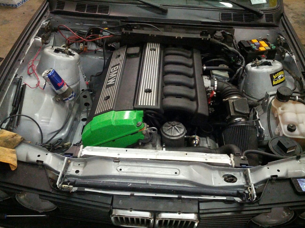

                    How do you like the kamotors intake? I'm thinking of replacing my unprotected K&N filter with one. I assume when you say E34 intake boot you are using an E34 525i intake boot? I saw a picture of your set up in another thread and it looks really clean so I may replicate it.
                    • James Crivellone
                      Head Janitor
                      • 6304
                      In the racecar
                      1. Engine
                      M50B25 Non Vanos, E34 Harness, 405 DME,
                      2. Drivetrain
                      Getrag 260, stock single mass flywheel, 6 puck sprung race clutch
                      3. Shift Lever
                      Modified stock 260 trans brace, bent stock shift selector rod, AKG Sportshift shift lever
                      4. Motor Mounts
                      AKG Urethane Swap/Race Mounts
                      5. Brake Booster
                      E21 Brake Booster
                      6. Cooling
                      Late model 325i radiator / expansion tank. 16inch pusher electric fan
                      7. Exhaust
                      OBD2 Headers, E36 downpipes, custom Y pipe into a single, Magnaflow muffler
                      • openthrottle
                        • Jul 2012
                        • 4
                        ^how much hp did the redbull can give?
                        :p
