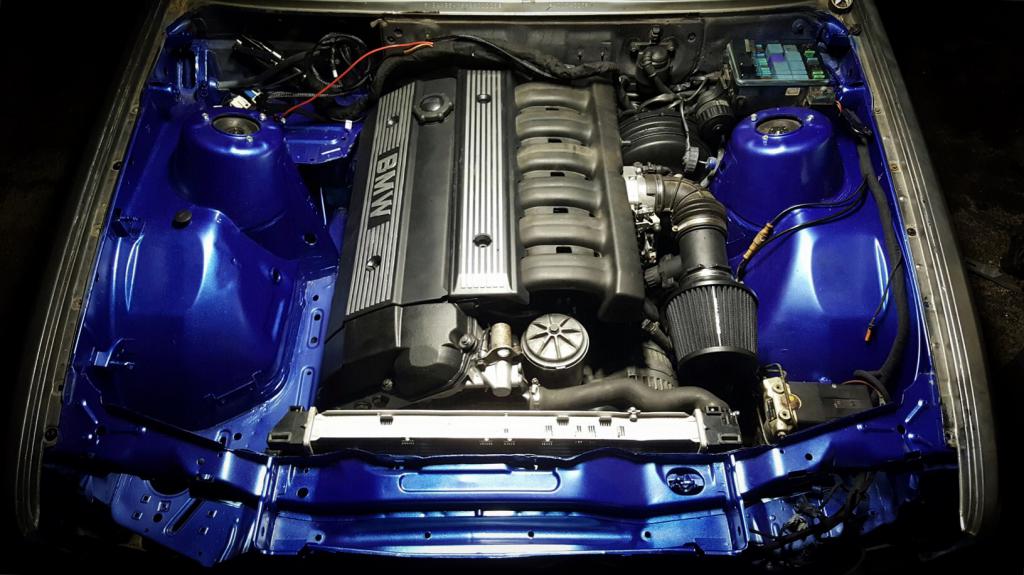

      #107
      1. Engine
      S52B32 with ODB2
      Stock S52 internals
      Stock ODB2 Fuel Rail, ODB2 FPR/Running Losses, Stock charcoal canister
      KAMotors CAI
      m50 oil pan, intake, dip tube.
      S52 stock CCV and it's related rat's nest of vac lines.
      Rebuilt S52 injectors by MMMPEG
      2. Engine Wiring
      ODB2 Harness, 100% verified, cleaned and tested to all 88 Pins on the DME. (First swap taught me valuable lessons, you get to delete everything you don't need and make sure everything works from the getko)
      Wired directly as a C101 male end connection instead of using a X20<>C101 adapter
      SAP/EWS/ASC and ABS (e30 body runs ABS) deleted.
      E36 318i Firewall covers
      Battery relocation to trunk
      3. DME
      Kassel MS41.1
      4. Drivetrain
      ZF 320
      E30 early model E driveshaft with large guibo
      Lightweight Flywheel/Clutch
      E23 735i 3.64 LSD 188-Medium Case (Franken Diff- Removed original 4.10 open, swapped LSD carrier from e36 m3 3.15 and used original 4.10 open halfshafts on the e23 differential)
      Garagistic 85a Poly Subframe, TAB, Diff and offset-CA bushings
      Red Sump Armor Skid Plate
      5. Suspension
      Koni Yellow Adjustables and Racing Dynamics vert springs
      Garagistic X-Brace (LOVE IT)
      6. Shift Lever and Linkage
      Converted from Auto
      E30 Manual Pedal Assembly, Clutch master and slave
      E36 M3 Shift linkage with Garagistic delrin bushings
      Z3m Short Shifter
      E30 Rubber Tans mounts on stock cross member (Had poly mounts and removed them, I had to go to the dentist after installing them originally....teeth grinding)
      7. Motor Mounts
      Condor Poly S5x Motor Mounts
      8. Brake Booster, Master Cylinder, and External Reservoir
      Massive Boosterless setup with e32 745i MC (Mixed emotions, but getting used to it)
      Brembo Rotors
      ATE Pads
      SS Lines
      9. Steering System
      E36 M3 Rack with a mix of e30/e36 lines.
      Cut and slotted firewall to accommodate the air bag e30 steering column....(no one tells you this, but the steering column needs to be moved down and to the right to clear the e36 rack)
      10. Cooling System
      Z3m Radiator and Late model coolant tank
      E36 M3 S52 Hoses
      80c thermostat
      16'' SPAL Pusher with 80c temp switch and override switch inside. Wired completely standalone from engine and body.
      11. Exhaust System
      Aftermarket Headers
      Vibrant Y pipe dual 2'' in/2.5'' out
      Borla Mid Section
      Magnaflow Performance Muffler
      2.5'' SS from the headers to the tips, no cat and two upstream O2's off the header.
      Old pics- but the thing runs like a Raped Ape!

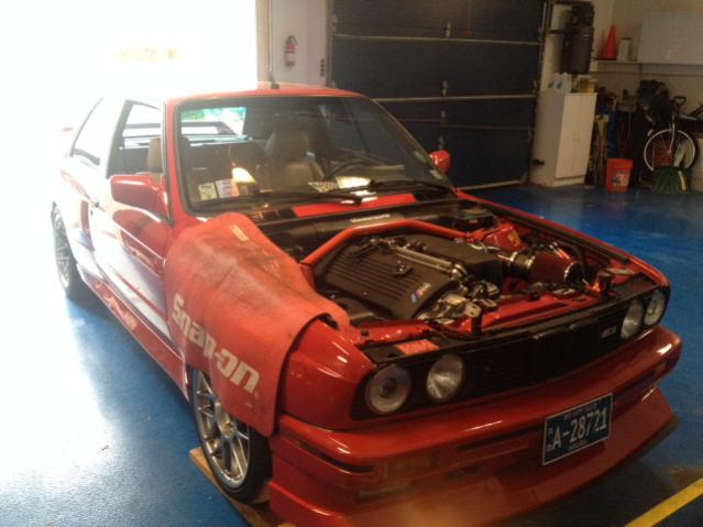

            #110
            Car: '88 WBS Vin'd E30 M3
            1. Engine
            2005 S54B32: fully functional stock obd2.
            Stock S54 cams
            Walbro 255 external and stock internal in-tank with Aero adj. FPR
            Dinan High Flow Throttle Boddies
            VAC U/D pulley for Crank
            A/C delete
            Intake: Bimmerworld silicone boot
            Stock E46 M3 S54 MAF sensor
            ECIS Replacement filter
            E34 oil pan with VAC oil pump and pan baffle
            Sump Armor-Red46
            2. Engine Wiring
            Wired by hand (no aftermarket harness used) Chassis harness to E46 motor harness
            3. DME
            Bimmerworld/Randy Mueller @ EPIC benchflashed my DME. Standalone MSS54 ECU setup
            Removed:
            -SAP
            -EWS
            -muffler valve
            - redline set at 7800rpm
            - Yielded 340rwhp/277tq on a dyno jet
            4. Drivetrain
            ZF320- 5spd from E36 M3 detent work done
            SPEC clutch and lightened flywheel
            E30 M3 clutch slave cylinder
            E30 M3 clutch master cylinder
            E30 UUC Stainless Steel Clutch hose
            325i trans brace
            E21 Trans Mounts
            E30 M3 driveshaft new CSB and Guibo
            2.93 LSD
            5. Shift Lever and Linkage
            OEM SSK Z3 M shifter
            Stock e36 dssr
            Delrin bushings, front & Rear
            E36 Ebay 5 spd M Shift knob
            6. Motor Mounts
            Green Motor mounts-E28/E34? (Cheap and inexpensive but great fit)
            7. Brake Booster, Master Cylinder
            2002 Booster (fits perfect, brake feel is firm and great)
            Stock M3 Master Cylinder and resevoir
            Brembo Gran Turismo Lotus 4 piston front BBK
            8. Steering System
            Stock steering rack
            New E30 power steering line and custom made line
            New E46 M3 power steering pump
            9. Cooling System
            New E46 M3 radiator
            E46 M3 O.E hoses
            Lower temp thermostat- Bimmerworld
            New O.E W/P
            SPAL 16" -Electric Fan with Relay kit 30102047 (straight blade-pusher).
            10. Exhaust System
            Stock OBDII S54 exhaust manifolds with chopped cats and custom 2.5 inch double piping. Custom merge-Y to mate OBDII headers to 2.5 magnalfow piping. 2.5 inch resonator and 2.5 inch muffler with double walled tips.
            All exhaust pieces were manufactured by Magnaflow and purchased from Summitt Racing.
            (With the merge being so close to the headers, I know its a bit restrictive down low in the rev band buy the car makes 320+ on any dyno so Im not complaining. I wish my E46 M3 sounded as good as this car. It is deep, European exotic and sounds amazing, not too loud but very deep with a nice scream up top to let the P-Car's know that I'm coming.
            If looks could kill:::

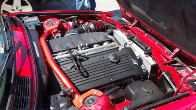

            • *freshm3
              • 174
              #111
              Few pictures from last year.
                    1. Engine
                    Stock S54 cams
                    A/C delete
                    Sump Armor-Red46
                    2. Engine Wiring
                    3. DME
                    Removed:
                    -SAP
                    -EWS
                    -muffler valve
                    4. Drivetrain
                    325i trans brace
                    E21 Trans Mounts
                    2.93 LSD
                    Stock e36 dssr
                    6. Motor Mounts
                    8. Steering System
                    Stock steering rack
                    9. Cooling System
                    New E46 M3 radiator
                    E46 M3 O.E hoses
                    New O.E W/P
                    10. Exhaust System
                    340 wheel hp from a stock s54 and 2.93? Lol nahhhh
                    You sure that's not crank hp it's calculating?
                    Got any pics?

                      #115
                      1. Engine
                      M52b28 block, S52 crank, Molnar 135mm rods, custom JE pistons, 8.5:1 CR, OBD2, S52 cams, full Supertech valvetrain, CES cut ring head gasket, OBD1 valve cover and coils, ATI Super Damper. Everything inside the motor is brand new. Every seal, every bolt. Good N Tight T3 manifold, Garrett GTX3582 turbo, Mishimoto 31”x12”x3” intercooler, M50 manifold, Rally Road fuel rail, Siemens DEKA 60lb injectors, tuned on stock Ms41.1 ECU by 22RPD. Arc Asylum modified and reinforced E36 oil pan with VAC baffle and E30 front subframe.
                      2. Engine Wiring
                      E36 OBD2 harness converted by Markert Motorworks for plug and play with the E30’s C101, E30 M3 firewall wiring harness cover.
                      3. Drivetrain
                      E46 M3 6-speed transmission (420G), Southbend Stage 3 Endurance clutch, OEM S54 flywheel, DSS custom driveshaft, E28 Euro M353i 210mm rear diff with E46 M3 cover, 3.25 LSD, custom rear crossmember fabricated. E30 reinforced subframe with Garagistic camber/toe adjusters, Z3M rear trailing arms and axles. Arc Asylum 420G trans mount and Rogue Engineering trans mounts.
                      4. Shift Lever and Linkage
                      UUC Evo3 Euro E36 M3 shift kit, new E30 shifter carrier bracket and stock bushing.
                      5. Motor Mounts
                      AKG 24V swap mounts
                      6. Brake Booster, Master Cylinder, and External Reservoir
                      New ATE Porsche 944 booster with threaded and shortened shaft, new E32 750 master cylinder with Wilwood proportioning valve, E30 stock master cylinder reservoir. Custom cunifer brake lines everywhere, ABS deleted. Shaved the last 3 intake manifold fins off for a little extra clearance. E36 M3 front calipers, E46 M3 front rotors, E36 M3 rear calipers and rotors.
                      7. Steering System
                      Z4 non-powered steering rack with E36 outer tie rods, custom made steering column u-joint with DD slip shaft to mate to E30 airbag steering column.
                      8. Cooling System
                      Mishimoto E30/E36 aluminum radiator, E30 late model expansion tank in stock location, Stewart high volume water pump, Fan Man Sidewinder puller fan. Fan motor sits where power steering pump used to be.
                      9. Exhaust System
                      Custom 3” turbo back stainless TIG welded, Vibrant resonator under the driveshaft tunnel and a Vibrant 3” in dual 3” out straight through muffler.
                      10. About a million and a half other things done to the car. It made 596 whp a couple months ago. Heading back to the dyno in a few weeks after making some changes to the fuel, intake, and waste gate systems.

                        Hey guys, since i got my car running i thought i would share my build. Since im from Bavaria Germany parts are plenty. I just have to drive to a wrecker to get everything i need. Everything else can be bought from dealer or ebay.
                        1. Engine
                        M52TÜ28B from E46 328ci which broke in half due to rust. got the whole thing for 1.3k, sold unnecessary parts for 800... Engine got a M54B30 intake and a tuned ECU to make it run at 239BHP. Oilpan is a E34 525 one i believe, got this second hand from a Rallye cross car. had several ground contact before so had to fix it with JB Weld. Oilpump schnorchel got re-welded to fit the new sump.
                        2. Engine Wiring
                        Bought a Adapter from Bruno Antunes on ebay, helped him do the translation of the instructions. This was a 300€ part. No customization needed tho. Plug and play, runs on every E30.
                        3. Drivetrain
                        ZF 5 Speed Gearbox, E36 328i driveshaft combined with E30 automatic center support bearing. Driveshaft needed some cutting (4,7cm shorter). Differential is a E36 compact (No idea about gearing) aswell as the whole rear axle. Wheels are 17" E36 M-Spec.
                        Lever is a shortshifter from ebay, Linkage is completly OEM
                        5. Motor Mounts
                        E28 5-series Motor bearings (70mm)
                        right side is E36 6 Zylinder engine mount, intake side is a special part from 300mm.de called 24V Adapter. Makes the engine sit perfectly with plenty space in the bay.
                        E34 525 Tandem Brakebooster and Master cylinder, same goes for the Reservour
                        7. Steering System
                        E30 OEM, no Powersteering (just because)
                        8. Cooling System
                        E46 328i Cooler, 2.5l Alloy Reservoir from China, Pusher fan from a wrecker Ford Focus or something (don't remember, just ripped it out of a shell)
                        9. Exhaust System
                        E36 320i headers, Stainless Steel exhaust system for Motorsport applications ofc flow optimized - has yet to be installed
                        10. Brake system
                        Front has 292mm Brembo special brake discs (Special cause they had to fit exactly for this project) aswell as E36 328i Brake Calipers. Got the adapters and discs from Tino's 300mm.de site, he sells whole 5 Stud conversion kits with all parts needed. In the rear i took everything from the E36 compact rear axle and replaced it with new parts.
                        So in total i spent over 7k in the last 9 Months. Bought the E30 as a automatic for the same i got the Coupè for, swapped everything, had to wait for space and parts or tools. Did everything on my own (except for engine extraction and insertion, so in total i had help twice) No Carlift, just jackstands and alot of me beeing on the ground under the car.
                        Would i do this again? - No.
                        Do i recommend this to Novice car guysor hobby mechanics like me? - No.
                        Did i buy alot unnecessary parts that didn't fit? - Too many...
                        Is it worth it? -Hell yes.
                        Maybe i do a follow up story of my build.
