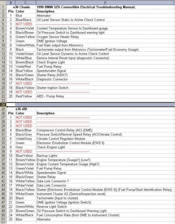

            Guys, what should I do with the pin 20 (ABS) color red/yellow and pin 10 (Oil level dynamic) color blue on the c101? I believe the pin 10 color blue is for the oil level sensor but where do I connect it to on the e36 x20 harness? Also with pin 20 (ABS) what should it connect to? Should I just take the pins out and run it like that?
            Bare in mind I have a 90 325i using a 95' m3 harness.
            SINdelle:E36 M3 5-Lug | 17x8 & 17x9 BBS RS | S52/ZF | 2.93LSD/3.5HFM/24lb Injectors/C&S Chip[B]SOLD[B]
            • bimerok
              • Apr 2007
              • 149
              #126
              If I remember correctly for the ABS you need just positive. I think I took it from O2 Heater relay (thats 1 of 3 relays on the engine harness).
              As far as oil level sensor wires - you only connect them to the c101 as the brains of alerting you about low oil is on the body and not in the ECU. (2 wires go to c101 and 1 goes to the ground anywhere)
              Good luck!
              • jahnaboi
                • Oct 2006
                • 1742
                #127
                So pin 20 of c101 could be connected as one with pin 6 (o2 sensor) right and both connected to pin 22 of the x20 connector?
                Also for the oil level sensor wire (pin 10) just leave it hanging out the adapter like some have done in this thread?
                • bimerok
                  • Apr 2007
                  • 149
                  #128
                  I can't recall for sure, but I think C101 pin 6 is a smaller guage wire that is an actuator for the relay. I made a "T" off one of the thicker guages from that relay and connected it to C101 pin 20.
                  As far as x20 pin 22 - i'm not sure why you need to connect something to it. pin 22 is a reverse light.
                  For oil level, just have 2 wires comming from your adapter (pin 2 and pin 10 i think on C101). Once everything else is sorted out you can connect the wires from level sensor then.

                    Disregard what I asked earlier. You said I need a positive for the abs. Could I connect pin 20 to pin 7 of c101? (Which is ecu/dme/ignition power) which is a positive right?
                    • bimerok
                      • Apr 2007
                      • 149
                      #130
                      You probably could, but the thinking I had is I don't want ABS to be on the same loop with any other "critical" systems and draw any extra power away, so that's why I didn't use ECU, Fuel pump, or anything else. To me O2 heater relay was a solid power from non-critical component.
                      But like I said, if you take power from any other source it will probably still work fine.

                        I connected my pin 20 of the C101 to with its own wire to the reverse light on the X20. Since the reverse light wire is no longer required, I followed it back up into the splice box and connected it to a red/white (switched +12) wire.
                        You get a dedicated wire for ABS and no external wires hanging out.

                            I know this is old but
                            Ok on an 88 is there much diff to the 89 and 90 or should this pin to pin diag. work
                            88 325 C101 to 94 M50 x20
                            1-25
                            2-1
                            3-X
                            4-12
                            5-23
                            6-22
                            7-21
                            8-24
                            9-20
                            10-2
                            11-7
                            12-8
                            13-13
                            14-14
                            15-15
                            16-19
                            17-X
                            18-18
                            19-X
                            20-3
                            You guys see any problems?

                                Attached is my pinouts sheet from when i was doing my swap (1991 325i 4 door/1995 s50).
                                Enjoy, Leo.
