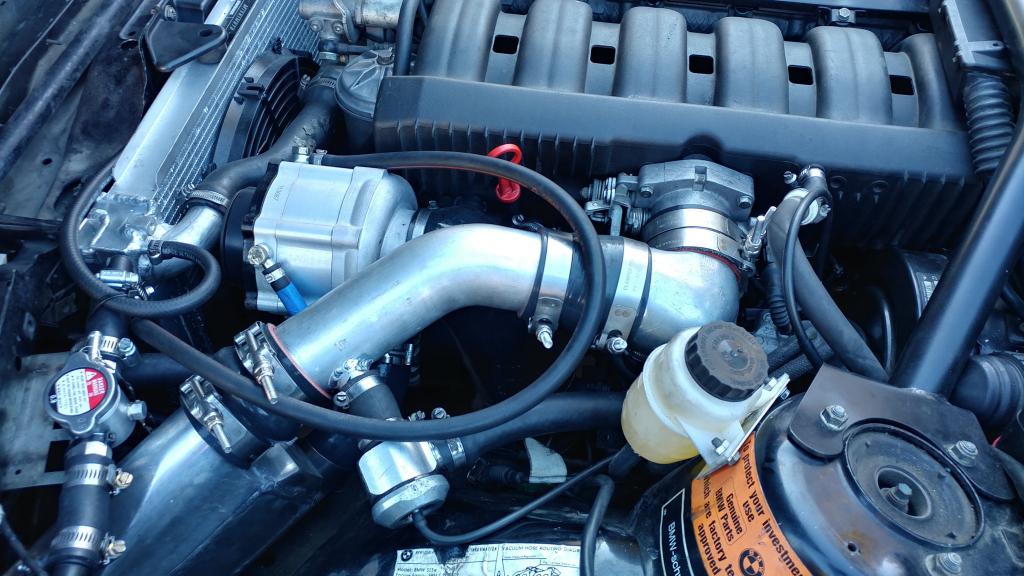

            Originally posted by Joe_Nycalive
            Can you post a link to the 2002 reservoir you used?
            I am in the process of starting my 24v swap and this setup sounds ideal for what I want to do,
            BMW brake fluid reservoir (or ATE brand) 34321112399
            I got mine new from ebay for $23 a year ago.
            reservoir installed
            Click image for larger version  Name:	1215191422a.jpg Views:	0 Size:	77.1 KB ID:	9920926
            brake master cylinder1

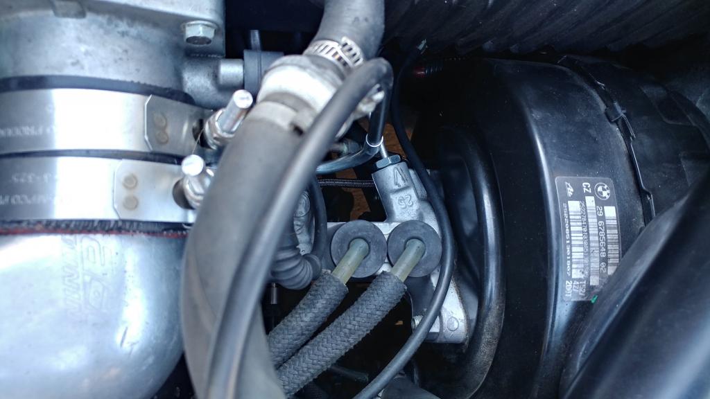

              is the e90 and x3 booster the same diameter? is the 944 wider?
              • Staszek
                • 2533
                #172
                The E90 and X3 booster are pretty close in size.
                The E90 booster is the same size pretty much throughout. THe X3 is wider then the E90 closer to the firewall, but is smaller farther away.
                That being said they both come out pretty far. The 944 booster was close to the X3 booster close to the firewall, but its not double stacked so it much shorter. Measurements below, I never measured the 944 but thats the one I used for my S54.
                E90 booster on left
                X3 Booster
                E90 Booster
                More pics

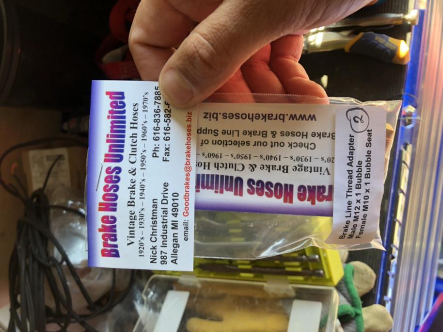

                    This is what I’m using for my setup, these adapters seemed a little difficult to hunt down. Or I was looking in the wrong place. Anywhooo e90 euro booster, and adapters should make this a bolt in affair.

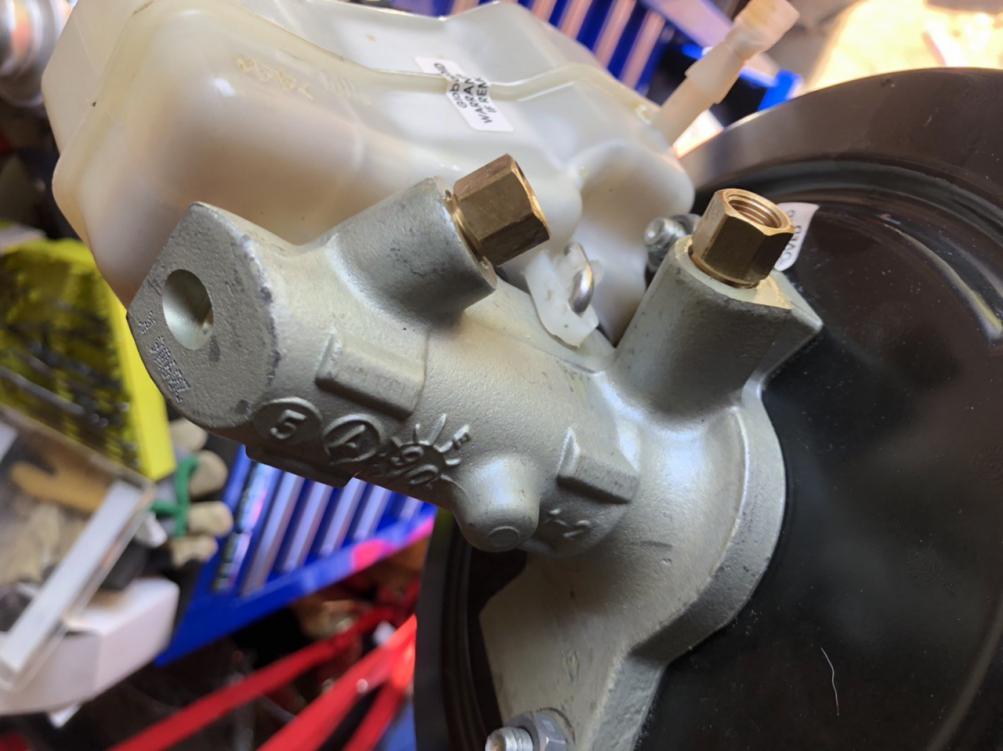

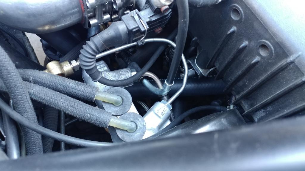

                      I used a brake booster from 2016 428i brake booster (G508673 vin). Works great - only needs a very light tap on the brake pedal. It bolted right up. However two mods were required. The rod to connect the booster to the brake pedal was a little short and like the e90 booster, the brake master brake line connections were on the engine side. I bought from Amazon 3/16 copper nickel brake line kit with fittings and made two short “U” line with bubble flair 10 mm fitting on one side and I believe it was a 12 mm fitting to go into the master. Bought two 10 mm bubble flairs unions to connect the new U lines to the e30 brake lines. Rather than welding the old clevis, I used the old e30 clevis inside the forks of 428i booster’s clevis. I drilled a hole in the e30 clevis at the appropriate spot to lengthen it and used the original e30 clevis hole for the brake pedal connection. Sent from my iPhone using Tapatalk Aloha Norm

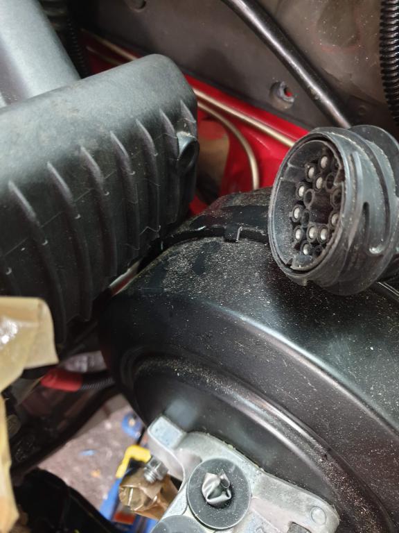

                        I am using an e90 booster with a m52b28 swapped engine...and it does not fit (intake manifold sits on booster) even when the fins are shaved. It might be due to the engine mounts (revshift 24v swap mounts). I am thinking of trying to heat and bend the manifold on its corner. Anyone knows if this can be heated and bent?
                        • jbontke
                          • Mar 2019
                          • 449
                          #177
                          Would it be possible to shim the engine mount and move the engine up and away from the booster?
                          • eternal24k
                            • Jul 2017
                            • 507
                            #178
                            i don't think you are going to have much luck heating and bending that manifold, I would also go with the shim route
                            • 318ti808
                              • Feb 2016
                              • 26
                              #179
                              Shimming driver’s side mount would be simpler. Have not confirmed, am told the engine torque is towards the passenger side so we do not have to worry that the motor when rev will hit the booster. Sent from my iPhone using Tapatalk Aloha Norm
