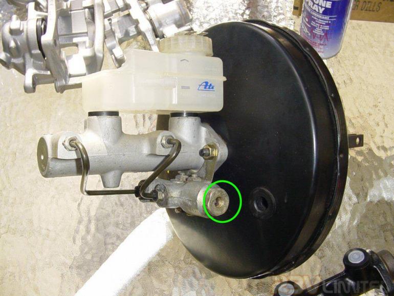

                            I'm trying to use an e90 booster in my 87' that HAS ABS, and I seem to have only one line running into my master cylinder's setup, its like connected to iteslf in 2 places (see pic)....
                            This is a stock pic i found on the internet but it clearly shows the current setup i have in my car, the 2 lines from the main master go to like a "secondary"? master and there is only one line connected to it on my car where the green circle is Click image for larger version
                            How do I properly connect my e90 booster if I do not want to remove my ABS......is it even possible?

                              #209
                              It's a proportioning valve only on those models/that year. I have the same. Some people get rid of theirs. I went through the extra effort to bend the lines and relocate it to underneath the master, positioned horizontally. See my post above, you can baaarely see it hidden under there. I'll try to get a better photo soon.
