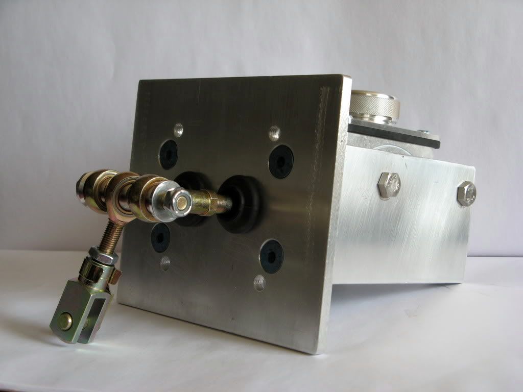

    Where? Through me. You can send me a PM or email me at mike at motomotions dot com. I will probably build them on an as-needed basis and I am having my welding (my skill suck) create a jig, so they can be cranked out quickly as necessary.
    They will be around $350 - $400. This depends on my welding cost and if I make the brackets out of aluminum, stainless, or mild steel (powdercoated). The price includes the bracket, master cylinders, metric brake line fittings, and clevis.
    I can also have the mounting holes moved up on the bracket if you are willing to relocate the mounting point on the pedal to improve the ratio.

            Tilton is kind enough to spec master cylinder size if you provide them some specs of you setup (piston size, pedal ratio, car weight, wt. distribution, etc...). They will give you a firm and soft option on sizes.
            I was spec'd 19mm masters for my setup and the pedal is firm, but not like Lee describes above. Similar to the feel of an E21 booster on a swapped car. I spec'd both cylinders the same size and kept the E30 bias valve. You can add adjustable bias by installing an adjustable bias control valve (Tilton / Wilwood) in the rear line.
            It should be fine on a RHD car as it was designed to mount in the stock location and incorporate the stock pedal mounting point. I assume the mounting points are the same for both LHD and RHD cars.

                    Matt, I have a drawing of the mounting surface for the booster if you need exact dimensions. All you would have to do is get the spacing for the master cylinder mounting stud and you would be good to go. Send me a PM.

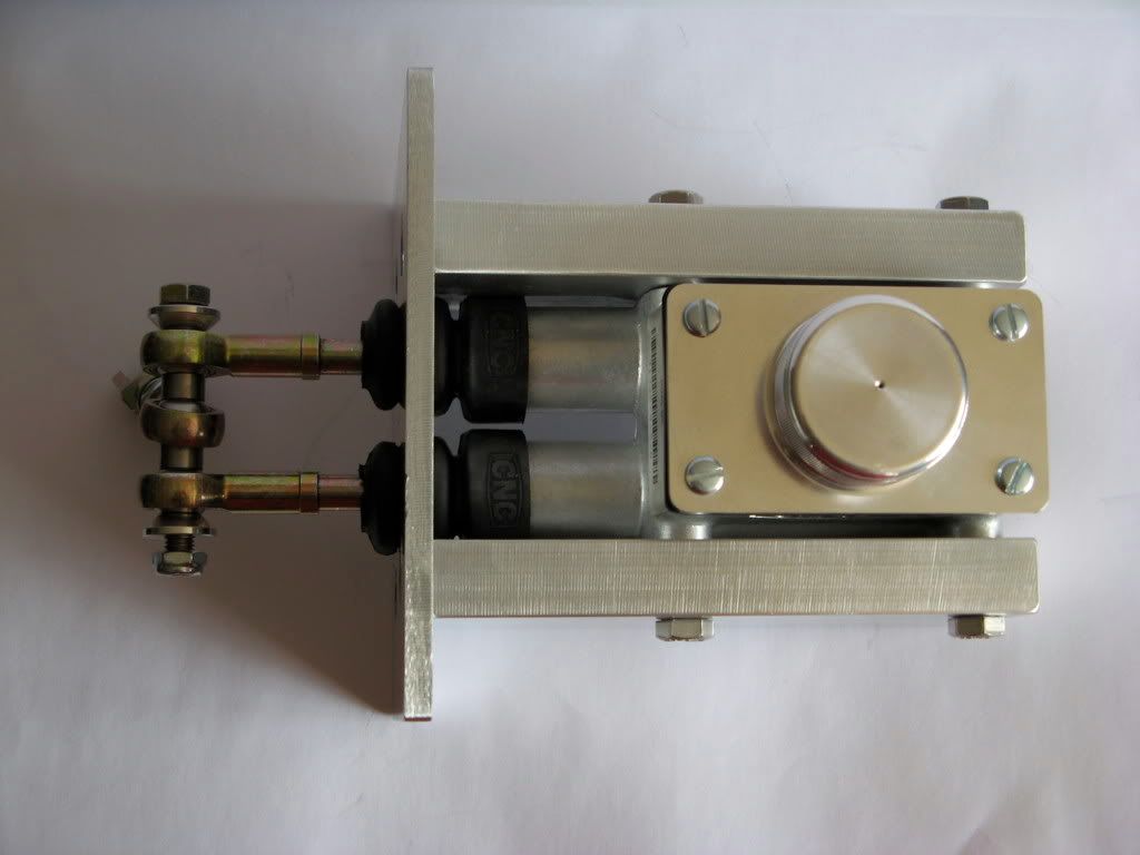

                      Here are some more photos of the dual master cylinder setup which mounts to the stock pedal cluster with no modifications. These are now available on an "as needed" basis if anyone wants one. I can also adapt your stock brake pedal on an exchange basis to change the pedal ratio from 4:1 to a more favorable 6:1.

                        Wow. That thing is so shiny, it makes me want to go out and buy an S50B32 just so I can install it! :mrgreen:

                            #118
                            It is a boosterless setup. The kit comes with bracket, dual master (spec'd for your car/brake setup), clevis, NPT to metric adapters, and firewall gasket.
                            Please PM or email me for pricing.

                                Hey Mike. Let me ask you a question about the kit. There seems to be a balance bar, but is the balance fixed allowing the same movement to both masters, or is there any adjustment. What approximative sizes are the MCs? I cant wait for you to do the testing on your BBK to order one for our racecar.
