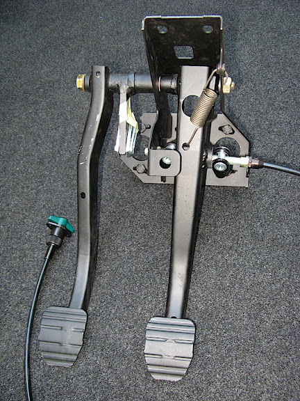

                          #132
                          Update:
                          I am now making pedal clusters with dual masters (or triple w/ clutch) that allow for balance control via cable. It will incorporate most aftermarket M/C's (Tilton, Wilwood, AP, or Girling)

                            #133
                            Hm. So the brake MCs sit inside the cabin, then are plumbed through the firewall, just like the clutch MC?

                                #135
                                The masters still mount in the engine bay. An additional hole(s) will have to be drilled. I have a template to make things easy for the installer.
