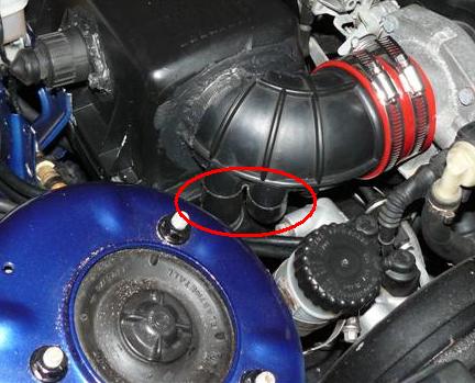

                      I notice everyone has two little ports on their E36 elbows. ONe is for a line from the idle circuit, and the other???
                      Check the two ports (circled)
                      I have an elbow with only one port. This gives me clearance issues with the brake master cyl. The port for the line coming from the idle control valve is too close to the end of the MC, so that I can't connect the hose. If I had two holes, I could just stick the hose in the one further around.
                      Help please? Part number?

                        #71
                        no room
                        Good to see the a/c box is getting worked out. If I see everthing correctly you have remote brake/clutch reservoris. I think you need to slot the orginal brake master at the firewall as other member have done or retain the orginal power booster/master cyl (25mm master) . Look at this thread and the part about knotching the intake manifold to give yourself all the room you need and NO shims under front mounts. good luck joe
                        • Mike B.
                          • Jan 2006
                          • 987
                          #72
                          [ATTACH]10455[/ATTACH]
                          TIA.
                          I got my airbox now. 40AUD, off a 535. I'm happy!
                          The other is for crankcase oil vapor recovery - PCV valve.
