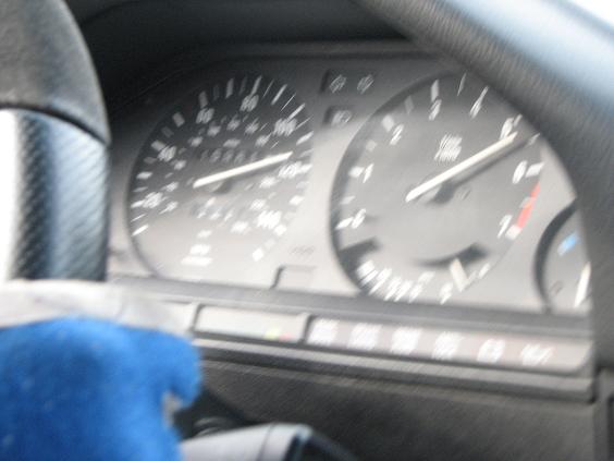

                  It is a 4.10, I confirmed that before I installed it. I have only done a TOP speed run one time, it was 132mph on some skinny, overinflated tires. I remember pointing it out to my friend who was riding along that we were only at about 6500 rpm's. I have since squeezed out a bit more power so who knows now.
                  Here is a pic that was taken at the track yesterday, I had actually made it to 118-121mph each lap before heavy braking but I would need a longer straight to get top speed.
                  A good bit of revs left, so I dont think what I am telling you is too far off.
