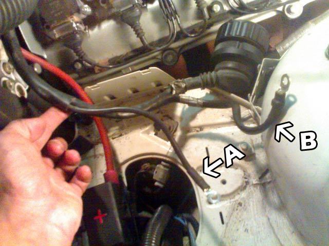

                  Ok I NEED some info on the wiring, not the C101 but the three eyehole terminals on the harness. I was told one is a ground and the others are hot. Two are right by the ecu plug and one is on the other side.

                  • FredK
                    • 14761
                    #654
                    Yes, there are three terminals on the harness.
                    1. The fat red cable goes to the main power block.
                    2. The black cable paired with the diagnostic connector gets connected to the shock tower ground.
                    3. The remaining thinner black cable goes to the 6mm post where the fusible link (the thin power wire coming from the back of the car).
                    • Mr.SWISS
                      • Nov 2005
                      • 1251
                      #655
                      1&2 done. The small black wire looks like a ground to me, I put it on the shock tower with the other one. Was that my mistake? I am waiting to get my CPS in b4 I go back to the shop to mess with it.

                      • FredK
                        • 14761
                        #656
                        Yes.
                        Peel the heat shrink back a little bit on the third wire, you should see that the wire inside has red insulation. This is definitely a positive wire. The one paired with the diagnostic connector should have brown insulation. You can peel back the heat shrink on this wire as well, to confirm where it goes.
                        If you have the engine ground strap connected (goes from engine mount arm to E30 chassis rail, there's a threaded stud near there that's perfect for this), the fuel rail ground (attaches between engine hoist eyelet and head), and coil ground (a ground strap that goes from one of the coils to the valve cover, IIRC), the engine should fire.
                        • FredK
                          • 14761
                          #657
                          Here's a picture from LooN, when he was wiring up the power for his swap.
                          A is power
                          B is ground
                          • Mr.SWISS
                            • Nov 2005
                            • 1251
                            #658
                            Yes.
                            Saw that when I was cleaning the bay so I went with it. the two ground straps for the coils are fine, and the one on the engine is cool too. I will go and check this out later today. Thanks for the pic.;)
