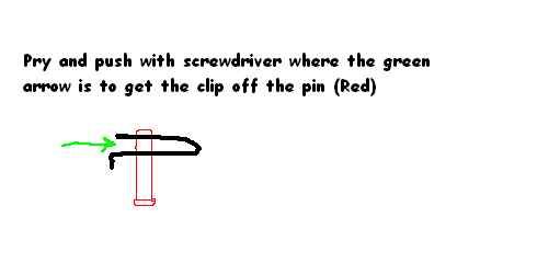

      oh.. the pin lock that holds brake pedal to the fork. You kind of spread it apart a little with a screwdriver and push it off the pin. it's hard to explain.... but look at it with the light and rotate it around and you'll figure it out
      Here is my horrible drawing representation of what that locking tab looks like. See attached.
