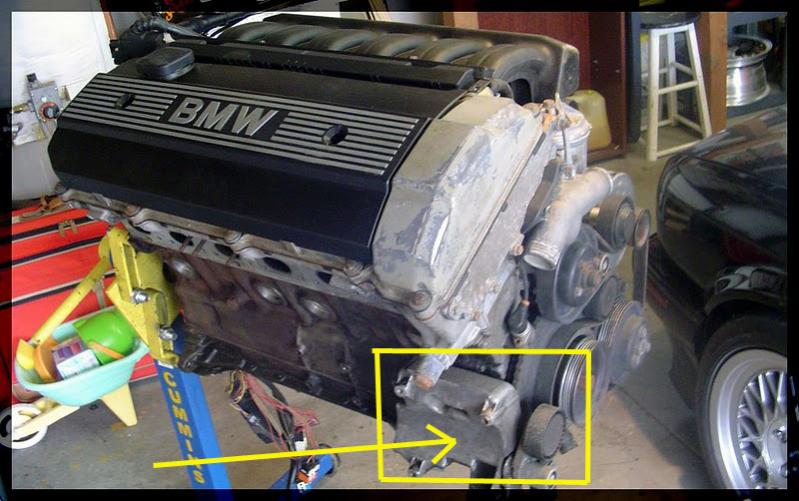

            Ok, questions time. This thing I have highlighted and pointed to is the A/C compressor bracket, right? I don't have A/C, nor will this engine. Can this whole assembly be removed and ditched, or does anything else bolt to it that I need?
              Nope. Just take it off.
                AWESOME. Thanks, Josh!
                  Yeah I took mine off completely as well. Maybe I'll regret it in the summer but until then, I'm ok.
                    Do I have to pull the whole big crank/cog thing off the front to be able to remove that thing?
                      Nope. Just take a small wrench and spin it off a few mm at a time.
                        It doesn't look like the bolts will come out all the way. I'll give it another shot.
                          It was a few months ago so I don't remember exactly what happend but I was able to take my ac bracket off without removing any of the crank pullys.
                            you just have to pull the 6 13mm bolts on the crank that hold the pulley on, then the 2 13mm in the front and 4 13mm on the side to pull the bracket off

                              Awesome, I'll check it out.
                                Went back and tried again, the pulley and the crank gear came right off after pulling those! A/C bracket removed, but I damaged my crank position sensor when I pulled it, accidentally put a big dent on the underside of it, probably rendering it useless. Anyone got a spare? If not, looks like they're only like $35 or so.
