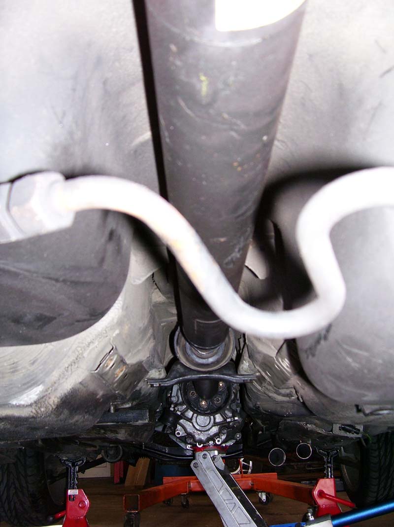

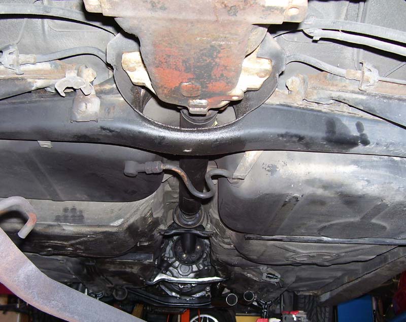

    m50 in, driveshaft not straight
    OK so I got the m50/getrag 260 in. green hex mounts, e21 booster, ebay headers.
    The engine and trans appears to be crooked, with the trans aiming towards the passengr side and the front of the engine towards the driver side, causing the drive shaft not to be straight. I've wiggled the SHIT out of them, lifted and re-settled them, pry'd them, checked for clearance at all points, etc...
    I'm waiting to make my trans brace until I can get this straight, but I'm just not having any luck. If I make the brace in a way that will move the trans over, it will just tear the mounts eventually.
    Any ideas?

                Well, for one, that would make the angle worse. And as I said, the driveshaft was never removed, I just pulled it off the trans and then put it back on the trans.
                Even with the driveshaft disconnected, the trans is way to far towards the passenger side.

                  I don't think you want to run it like that, driveshaft should be straight.... as it starts to rotate it will rape your csb and possibly more.....

                    Yeah I just drew a straight line over it in photoshop, and now I see just how far off it is. I'm not driving it like that.
