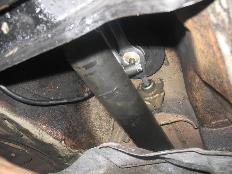

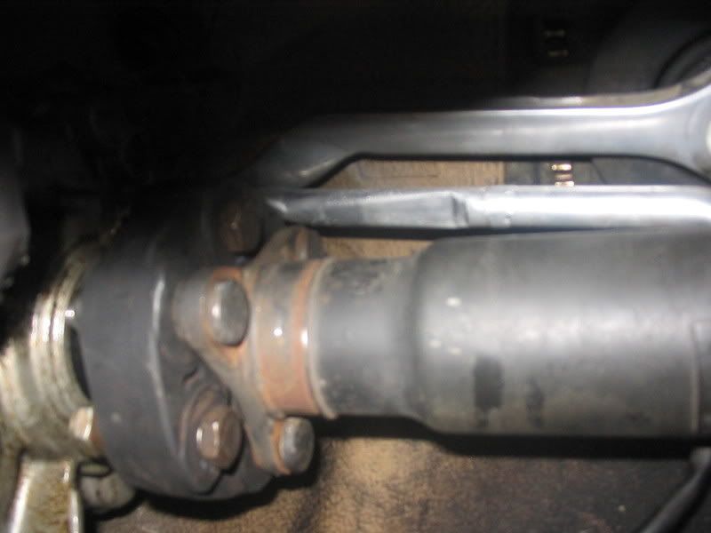

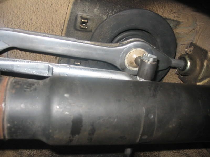

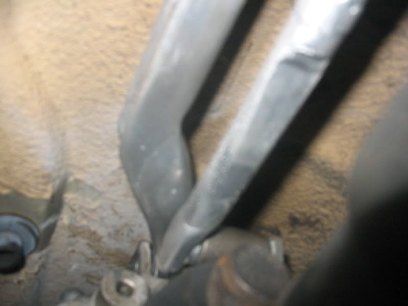

    As the title states, Ive had a modified shifter carrier and selector rod for several thousand miles in my cabrio.

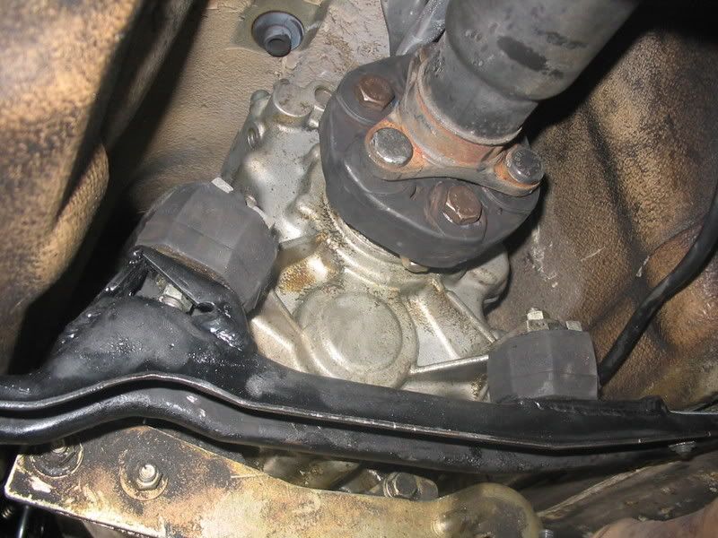

    I modified them as precisely as i could and apparently i did something right. The shifter works perfect and even with a SSK. I wanted to wait a while before duplicating this for a sort of R&D period. Yes, the shifter is centered. That was the point of this mod. I can sell a "Kit" with the modified trans mount too.
    So now im ready to offer my services to you guys, What should i charge and will there be any demand for these? I will be welding aluminum and steel.

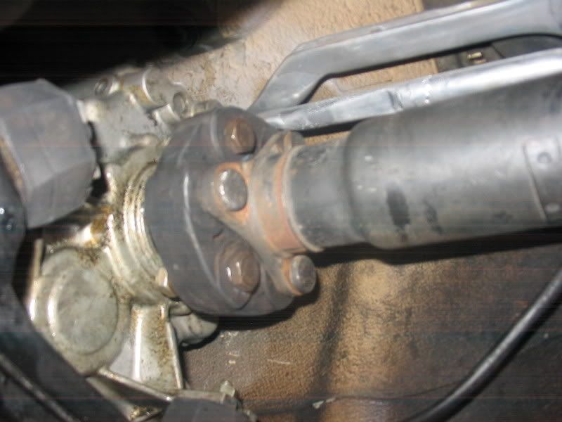

                  I did mine during the conversion but it took some time that I was short on, especially since I had to make some adjustments for trial and error; and take everything apart again when it rubbed the driveshaft slightly in 5th gear. Z3 shifters make this a little more critical.

                      I'm confused, I'm using the Getrag 260 with my M50 swap and all I did was bend/twist the selector rod a few degrees then bend the new shifter to match the stock on and my shifter is centered just fine.

                        i would suppose thats obviously possible. It gave me piece of mind to have mine welded, to avoid any problems(if any)

                            thats probably the difference. Because with the aluminum, i didnt see any way to do it, without making it look awful and functioning about the same.
                            Because Cast aluminum tends to break if you twist it.
