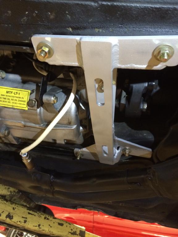

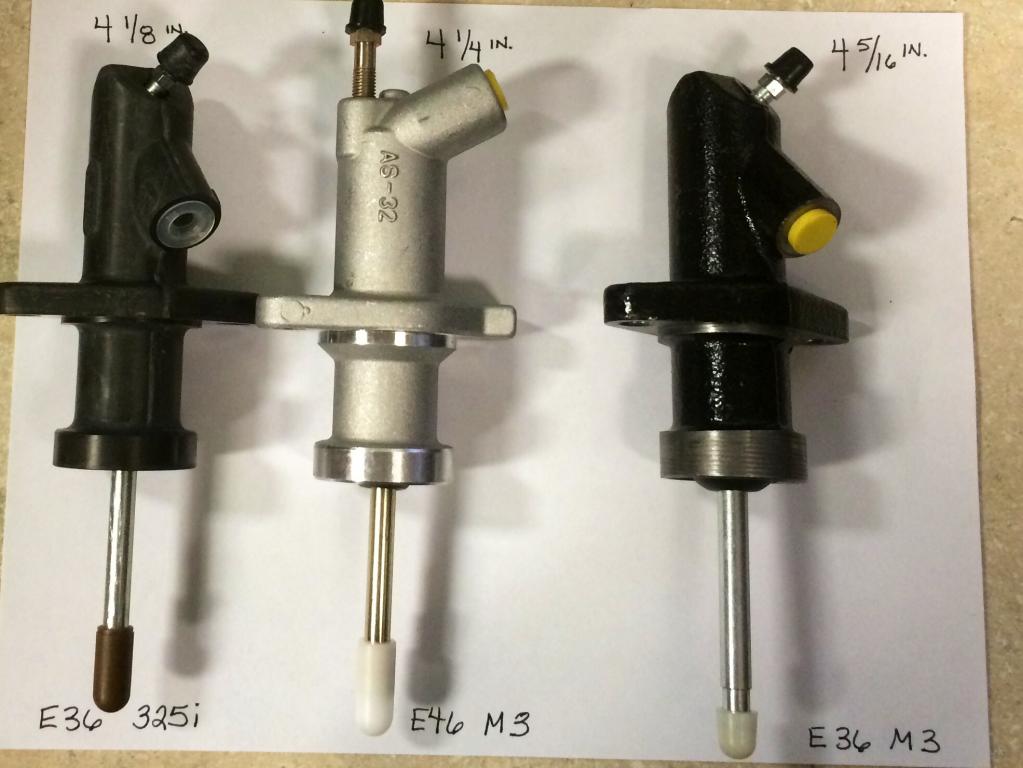

                        Just a quick update for anyone doing this swap and gathering parts. I've purchased a custom brace from Tyler at ArcAsylum that I'm very pleased with. Also if you follow most post about the slave cylinders for the e36 325is, the E36 M3, and the E46 M3 having the same rod lenth they are wrong. The one you definitely need is the E36 325is slave. This particular slave is just over 3/16 of an inch shorter than the E36 M3 slave. Using the E36 M3 slave will cause the clutch not fully disengage and clutch slipping will occure. Ask me how I know this.

                          Tyler's brace

                            Thanks for the update. Any truth to an e36 auto x brace working? You have contact info for Tyler?

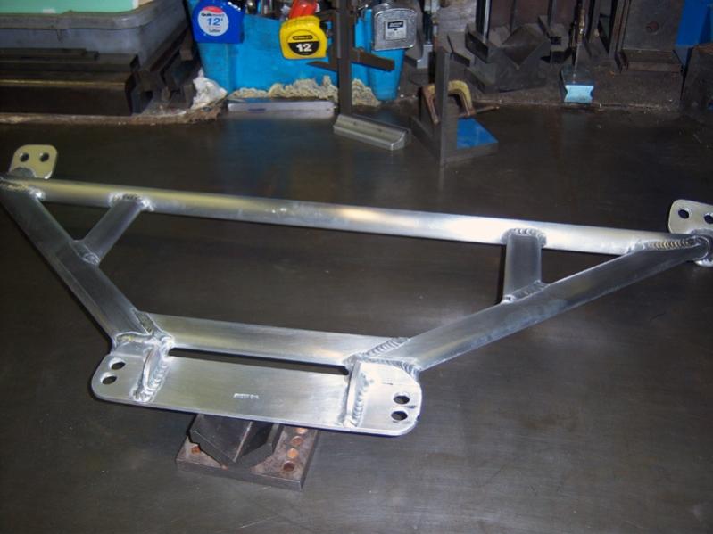

                              Never tried the E36 Xbrace. Just bought one from Mason Engineering.
                              http://www.masonengineering.net/Subpages/E30.htm
                              Tyler's sight
                              http://www.thearcasylum.com
                              Or
                              https://m.facebook.com/TheArcAsylum?_rdr
                              "A casual stroll through the lunatic asylum shows that faith alone does not prove anything."
                              Friedrich Nietzsche
