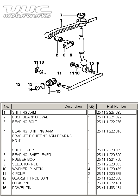

    For the shifter you need the e36 M3evo 6-speed parts:
    Thats everything in the above pic EXCEPT 12,13,14,15. You NEED 1-11! this will slide into the late modle e30 rear shifter support. For early e30s(pre '86) you need to convert to the later style mount.
