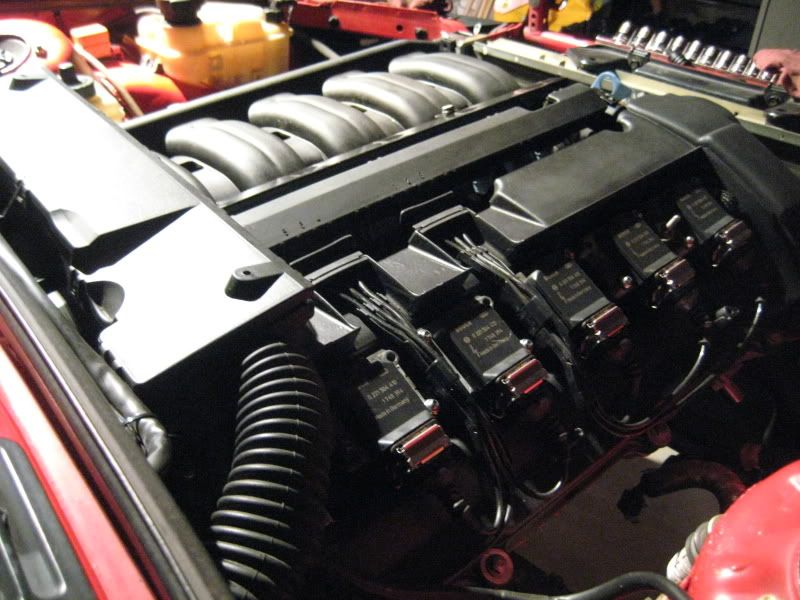

  • jahnaboi
    replied
    12/7/08
    Here's the update!
    A picture of my ghetto jimmy rigged e30 temp sensor for my cluster. I live in socal so I deleted my coolant lines to my throttle body as temperatures here in So Cal don't really get that cold (818).
    Picture of my 24lb Bosch injectors.
    And here's where I am so far... just really small stuff to connect like throttle body boot, hfm, and I need obd1 mid pipes. Anyone got any?
    -Jasper
