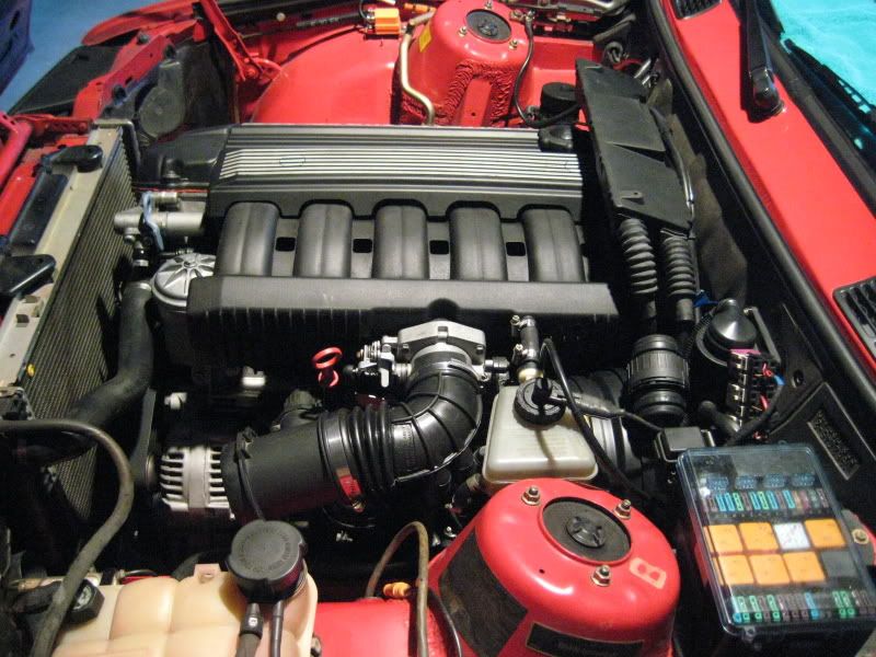

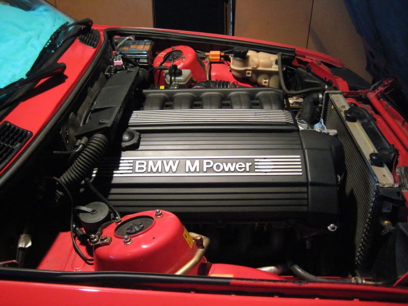

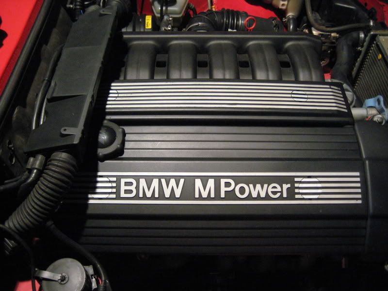

Pictures up:
Don't mind the intake, still haven't bought a 3.5" intake. I will soon.
I'll post a video soon, maybe tomorrow 0 - 60. =) Just so you guys see.
