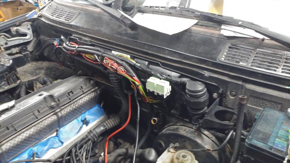

            Thought I had a pic somewhere...
            john@m20guru.com
