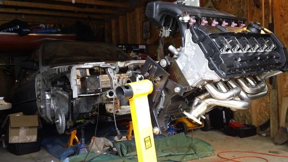

    Just looking to see how others have their coil packs grounded! Trying to hunt down a bit of a rough idle and realized that I didn't do any actual grounding straps on the coil packs.
    I've seen setups where every single pack is grounded, they are all daisy chained together to 1-2 ground straps on the ends, just 1-2 grounded and the rest not...
    What's best? Does it matter at all?
    And what's the best way to secure a strap to the valve cover bolts? The ones I have are quite large nuts in the middle that would take a big ring to go over it!
