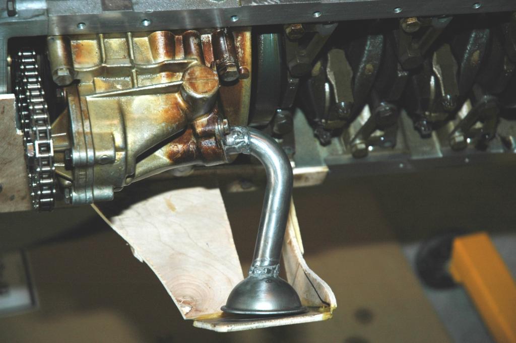

                Engine is loaded in the back of the Durango, ready to get the oil pickup tube made. Taking it in on Monday, tried to take it today, but they were out at an event and had nothing about it on their answering machine...

                  Engine is at the shop now for the oil pickup tube. It'll probably go back there in the future for the turbo oiling needs. Got my trans brace in from White325is today as well, looks great.

                    Hardest thing is knowing where to put the pickup. I made a little plywood form that mimicked the bottom of the oil pan.

                      #40
                      My mechanic has done these sorts of swaps before, I've got confidence in his ability.

                        #41
                        I'm sure he hasn't adapted too many M54s to e34 oil pans. He can't just swag it, the pickup needs to be in the right place.

                          #42
                          He has built plenty of BMW based track cars though.

                            #43
                            Just got the engine back, the oil pump nut was loose, he welded it on. The pan is now attached and the oil pickup is made. I'll have to take the pan back off at some point though, I didn't get a chance to relay to him to leave the pan off it, no worries though, a gasket is cheap. I talked a lot of shop with him, threw some of my ideas out there. I'm probably going to go with a .85mm thick head gasket to bump the compression down a tad, I'll likely be going forged pistons and upgrading the rods as well. I talked to him about boring/sleeving it to 3.2, but the gains wouldn't really be worth the cost. I also talked ECU and tuning, and he's convinced I can run the MS43 without having to have all of the other stuff like EWS, meaning I wouldn't need to use the key, he's telling me there are ways to trick the ECU, so if he's correct, I'll probably still wind up running the stock ECU and tuning it for the boost. He also said it'd be a more reliable ECU than the older M50 and S50 ECU, and another benefit would be not having to hack up the wiring harness, and I could run both VANOS's that way. We'll see, I'm sure I'll be sitting down and talking with him more about this as the swap progresses. He also mentioned a cast exhaust manifold that's supposed to be excellent for these types of projects, but he couldn't remember the company name, so he's going to be looking that up for me. He seems as excited about my project as I am, and I'm not even going to be putting any money in his pocket besides the trade of the E46 shell with its torn rear subframe mounts
