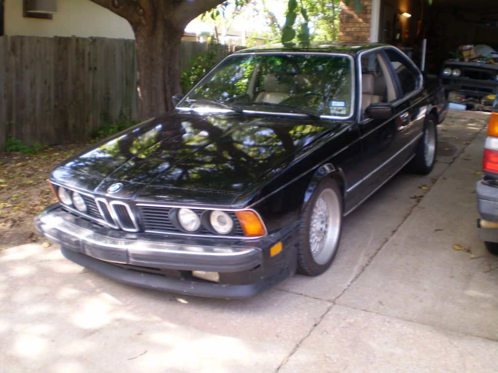

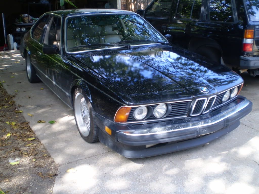

      Haven't had the budget to work on this, kinda sucks, the E30 is just taking up space right now in the garage and the M20 and M54 are just taking up space in my driveway... I did pick up a new daily though, my Pathfinder's transmission decided to kick the bucket. Found an 87 635CSi, guy wanted 2300 for it, I got him down to 1700 and snatched it up. Pics:
      Style 5 2 piece wheels, roughly 150k on the odometer, E30 sport seats retrofitted, 5 speed swap, 3.46 open diff, tan and brown interior. All around decent car, though I did have to replace the entire rear subframe, as the passenger side trailing arm mount had completely ripped out. Luckily, I had gotten one for free a few months before. I'm going to have the broken one repaired and have camber and toe adjustment welded into it.
