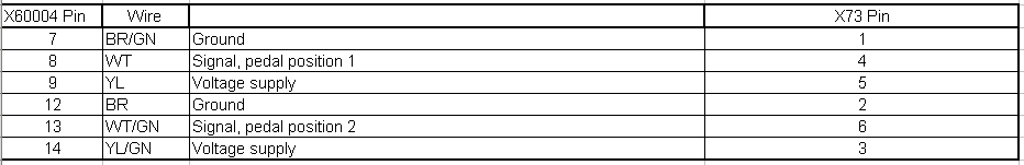

                          Originally posted by Andrew325is
                          Also, the pin #’s for the gas pedal on the wiring instructions and also on the ETM (or WDS) do not match the pin #’s on the actual gas pedal connector. Obviously someone who reuses an old connecter can go by the wire colors, but I encountered this problem because I used a new connector with new pins.
                          Yes, the ETM lists it as an 8-pin connector, but it's a 6-pin.
                          I've attached the pinout below for future reference.
