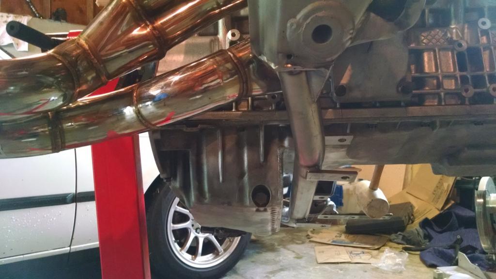

    It all seems to fit.
    As a bonus, the sway bar is relocated to the front and the subframe is narrower, so fewer issues with the headers. Raceland, in this case.
    Nice work by Tyler at the Arc Asylum.

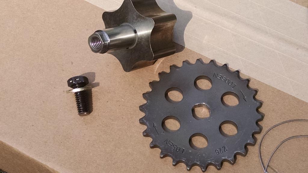

    Upgraded oil pump shaft from Achilles Motorsports. No more nut to come loose and the shaft is tougher. They even pressed it into my pump rotor.

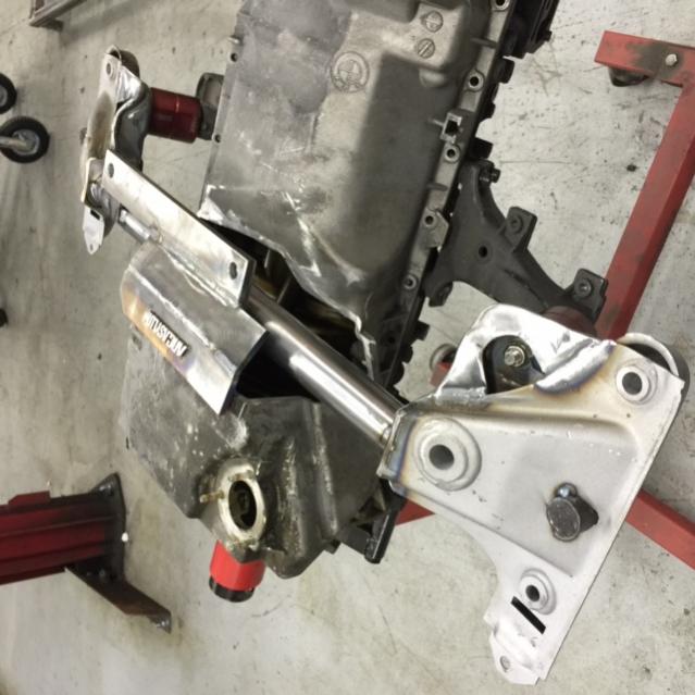

  • hoveringuy
    replied
    Tyler sent and update with this picture.
    Leave a comment:
  • hoveringuy
    replied
    Update. Head is finally back from machinist and bolted back on. Machinist didn't do anything radical, but replaced the exhaust guides and completed a firs- rate valve cut. He also drilled the exhaust ports so I have 4 studs per port.
    I have not yet installed cams because I'm going to hold-out for Schrick cams. Anyone have a set to sell me??
    Next up is mailing the oil pan and subframe to Tyler for mod.
