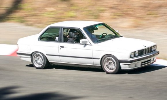

    First HPDE a few weeks ago. Engine was great; pulls hard where it needs to and keeps up with plenty of "M" badges. I had a blast and have a long way to grow my abilities to match the car.
    Pacific Raceways or the Ridge?
    Ive been day-dreaming how my car would be with a M54 motor... Miss that torque
