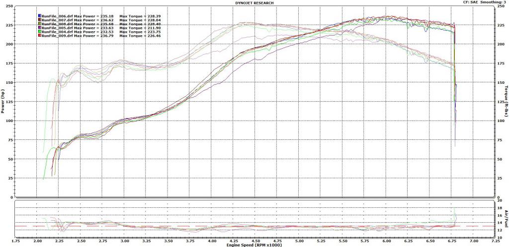

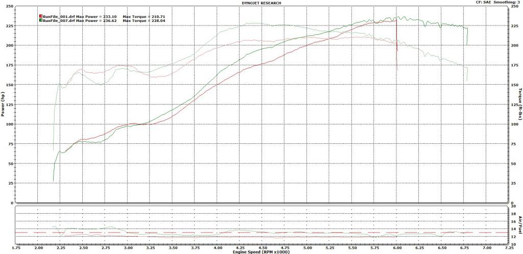

    Hit the dyno this morning. I tried some different VANOS profiles, mostly intake, and some slight timing adjustments. I found that it likes a little less intake advance below about 3000, it responded nicely to exhaust retard above about 4500, and I got a 2HP bump by advancing my timing 2 degrees across the board.
    Unfortunately, I didn't do a run where I could incorporate all of those changes into the same run. The attached shows my baseline tune with 10 degrees of exhaust retard across the board, which made it suffer on the low end. It's compared against the pull when I first installed the motor, with the oversized and obnoxiously loud headers.
    237WHP is decent considering I have OBD2 headers.
    If someone could explain why I have a peak at 2500, a drop at 2750 and another peak at 3000 that would be swell.. I did get that to flatten out by having less intake advance.
    Here's all the runs together:
