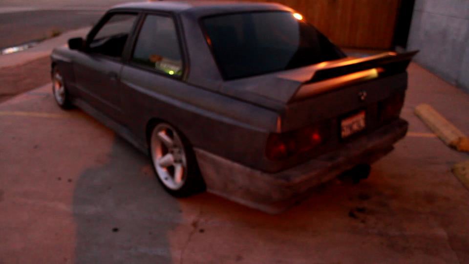

              Dual 2.25" is the smallest you want to go. I ran dual 2.5" with 2 mufflers and headers, and it wasn't THAT loud.
              I ran a FloPro center muffler and anActive Autowerke Gen 3 rear muffler from an E36 M3. Castro Motorsport runs the same middle muffler with a Borls ProXS out back and it sounds greatas well, is a bit quieter and still performs great.
              My old M3:
              This is "Castro Motorsport S54 E30 M3" by Chris Bialy on Vimeo, the home for high quality videos and the people who love them.
              If going with a single system, the merge is super important for low-end and midrange torque. A good tuner can tune out some of the torque loss - heavily dependent upon the Vanos mapping. Single 3" or 3.5" on any car is loud unless you run 2 pretty big and typically more restrictive mufflers. I have an s52 in my Ti with 3" and have a Vibrant Ultra Quiet resonator, another 14" Vibrant resonator and a Borla ProXS out back. It's pretty quiet at idle and at lower rpm, but definitely has the loud sound I want above 4 rpms and at WOT.
