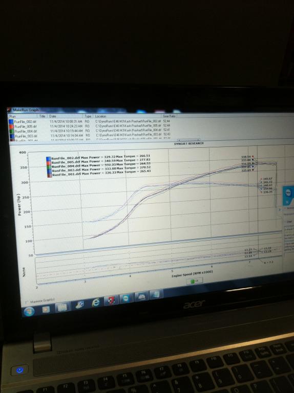

                    ......Love it when Fred chimes in on an exhaust thread. Makes me want to chime in as well.
                    I'm not a fabricator, nor do I weld. I do have a great exhaust fab'er so I will list the parts that I provided him to make my custom setup:
                    I used O.E U.S S54 headers with chopped cats with a common 2.5 inch dual pipe setup.
                    Please note that all parts are stainless steel Magnaflow purchased thru Summit Racing other than the standard stainless 2.5 inch exhaust piping.
                    Quantity (1)- Y-Pipe 2.5 inch inlet/2.5 inch outlet 10 inches long(mfr#10768)
                    Quantity (2)- 2.5 inch inlet/2.5 inch outlet 20 inch muffler/resonators(mfr#10416)
                    Quantity (1)- Back Piece/Axle back Muffler 2.5 inch inlet/2.5 inch outlet 20 inch(mfr#12216)
                    Quantity (1)- Exhaust tip straight/rolled edge 2.25 inch inlet, dual 3 inch outlet 10 inch
                    (mfr#35167)
                    Everything is mandrel bent. We ran behind the exhaust fabricator with a few cans of flat black high temp rust proofing spray to make everything look pretty as he was making his art.
                    I would love to send you guys a video of the beast on the dyno to hear it open up post 3.5k.
                    As Fredk and e30Polak are aware...the car made 340rwhp/277tq on a dyno jet. The dyno chart showed that I suffered down low which I personally suspect as the merge collector being too close to the headers. Randy from EPIC wants me to go CSL airbox and re-tune to go north of 350+.
                    If you look at the dyno runs...constant numbers
                    If looks could kill:::

                      340 whp is beast mode! With a CSL box 350whp should be easy to get!
