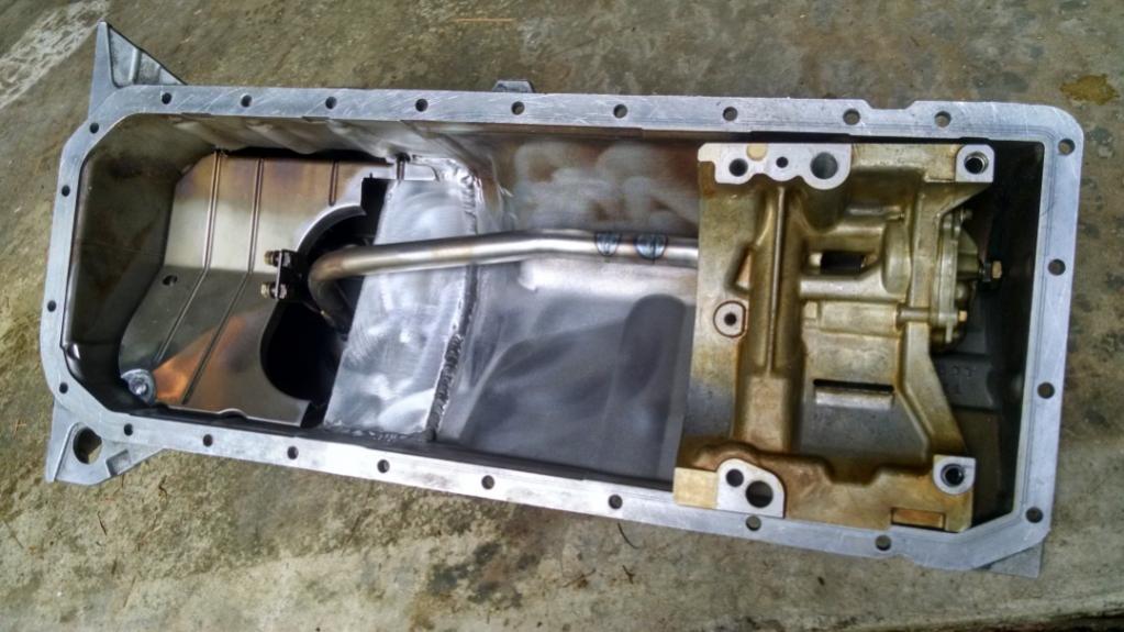

                  Tyler did my M54 pan and here's how it looks with the pump, pickup and baffle.
                  Workmanship is excellent and I'm excited to remove the low-hanging e34 pan!
