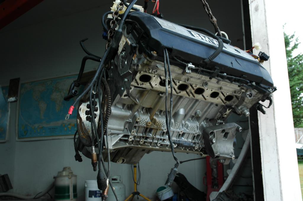

    M54. Let the foolishness begin.
    I have the motor. It's nice and shiny all over! It needs some attention before I can even begin to think about getting it running or installing it.
    I'm stubborn so I'm sure I'll make something interesting out of it.

                          The motor came apart like butter and I've had a good look at the head. I was hoping for the "Eureka!" moment when I could see what was causing it to blow white smoke but couldn't find that. No visible cracks in the exhaust valve seat area like I feared.
                          So, it's off to the machine shop for pressure testing. At this point it was either just a squooshed head gasket or a there's a crack somewhere else in the water jacket.
                          It also looks straight with the best straight edge I have.
                          Could I be lucky enough that it's just the head gasket??

                            Check for a crack in the area between #5 and #6 spark plug bores in the top of the head. I've seen about a dozen of them. Usually the tell tail sign is the milkshake lookin coolant. And I'd recommend replacing the camshaft ledges (trays) and all lifters...depending on mileage and visible scoring on either surfaces.
