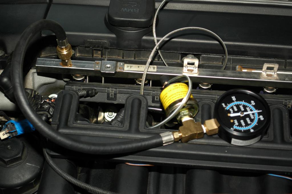

                                Fuel Pressure
                                So I've been having an issue with it running lean at WOT and higher rpm's. My LM-2 is confirming what my dyno session showed and has been great for gathering tuning data.
                                I have a suspicion that it's the chip tuning, but before I go down that road I want to eliminate fuel pressure as the problem and confirm that it's where it should be. I checked my static pressure long ago and have had it set to 51 PSI (3 1/2 bar) and confirmed that when I remove the vacuum hose the pressure goes up about 10 PSI.
                                What I didn't know was what the pressure was doing while I was actually driving it, so I ordered an oil pressure sender and gauge to read fuel pressure directly. I plumbed it into my existing fuel pressure gauge for convenience.
                                It is rock-steady at 50 PSI and climbs slightly at WOT. My fuel pressure regulator isn't the greatest but it's not the problem.
                                Time for chip tuning!
