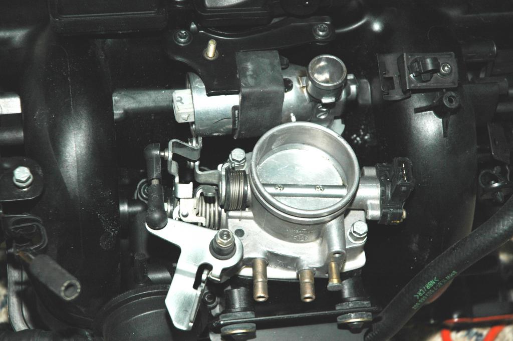

                    Throttle body
                    I got my Turner Motorsport adapter plate in the mail the other day and I thought it would make it easy to mount the throttle body to the M54 intake, but it didnt' work. I should have read the description closer and seen that it was for an M54b25 intake, which has a different layout.
                    Oh well.
                    I fabricated my own adapter plate out of HDPE plastic which ended up working really well. HDPE is the same stuff cutting board is made out of. My wife is still looking for ours...
                    The throttle body is tilted enough to clear the linkage from the coolant tube at the bottom and the ICV at the top, but is still perfectly positioned for the stock intake boot and for the throttle cable.
                    I still haven't decided on the injection system. I'm leaning towards OBD1 with a red label 413 and Turner S50 chip I have laying around. However, I looked at the front of the motor closely today and realized it doesn't have the mounting point for a front pickup like the M52 does. Doh!
