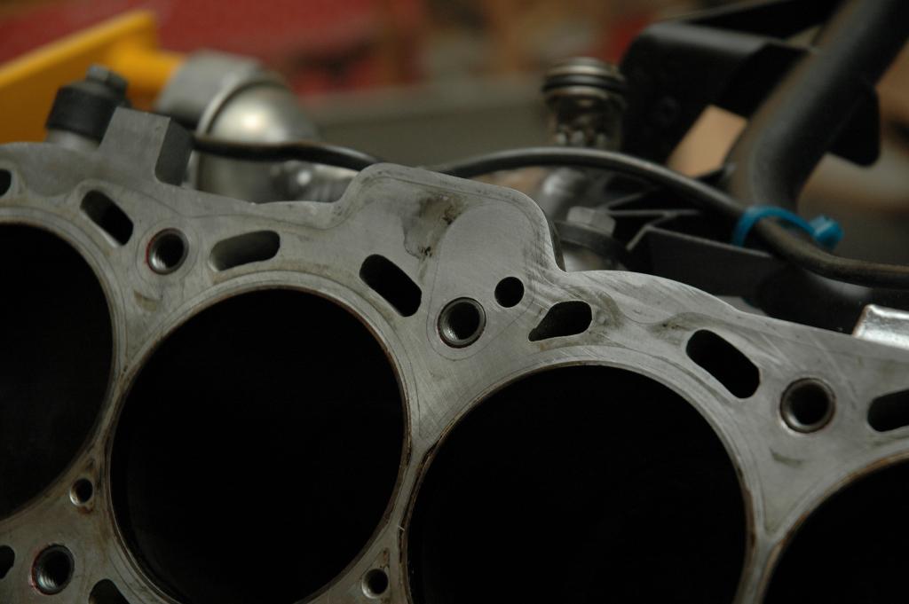

    Time Sert
    Time Serts are in and the head is torqued down. I'm not a smoker but I sure could have used one waiting between the first 90 degrees and second but thankfully it held and didn't yield.
    The Time Sert is a full 30mm insert that comes to within 1 1/2 mm of the top. The other option is a 24.5mm one that is recessed 6mm like stock or the generic head repair version that Baum Tools sells, which is 24.5mm that comes up to the top. I chose the 30mm because of potential weakening of the aluminum and I can use all the surface bite I can get.
    I also measured the old bolts compared to the new and they were from 10-30 thousands longer. Wow!

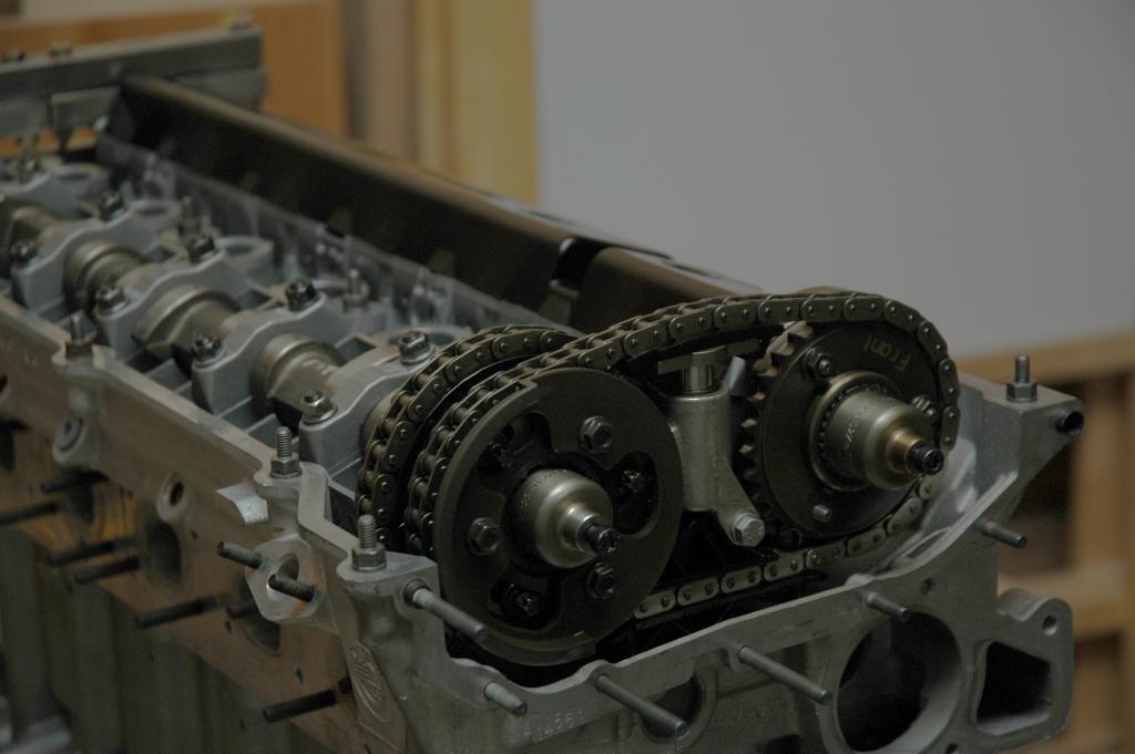

      dual VANOS, ready for timing
      Head is back on, cams are re-installed using the tried-and-true Pelican method.
      The dual-VANOS is a little more complicated but I have it all together and am waiting on the timing plate that sets the depths of the two plungers for the proper timing.
      Overall, it's very close to putting the M50 together with a few small differences.

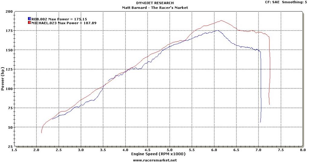

                BMW motors make the power BMW wants them to make.
                Then I come along and give you the rest of the power back. :twisted:
                This is another company's performance chip vs our custom tune that actually gets 100% of the performance out of the motor. Both motors are 100% stock M50TU.

                  Much smoother rev-band.
