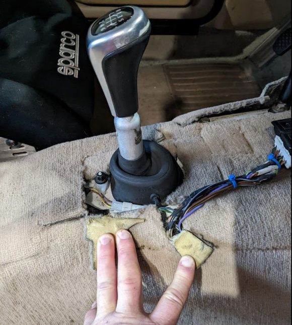

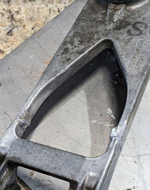

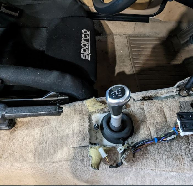

    With the Z4 motor mounts, one thing that fits slightly less than perfect is the shifter. It works as-is, but it's aft of center enough to be annoying. I removed 1/2" from the shift carrier and also from the shift rod.
    Much better now...
    Before:
    During:
    After:

      Nice work! I still have to lengthen my DSSR selector rod to fine-tune my shifter position. It's nice to get things feeling like they're in the right spot.
      Aside: Not sure if you're using the same kind of lower boot as I am, but it looks like it should be pulled up by one "notch".
      • hoveringuy
        • Dec 2005
        • 2744
        Its in the correct groove, but may not look it
        The nice thing about doing this is that the shifter placement can be adjusted *exactly* right with some tweaking of the selector rod
        I put an expansion pin on the inside of the rod which aligned it and let me adjust it before I welded.
