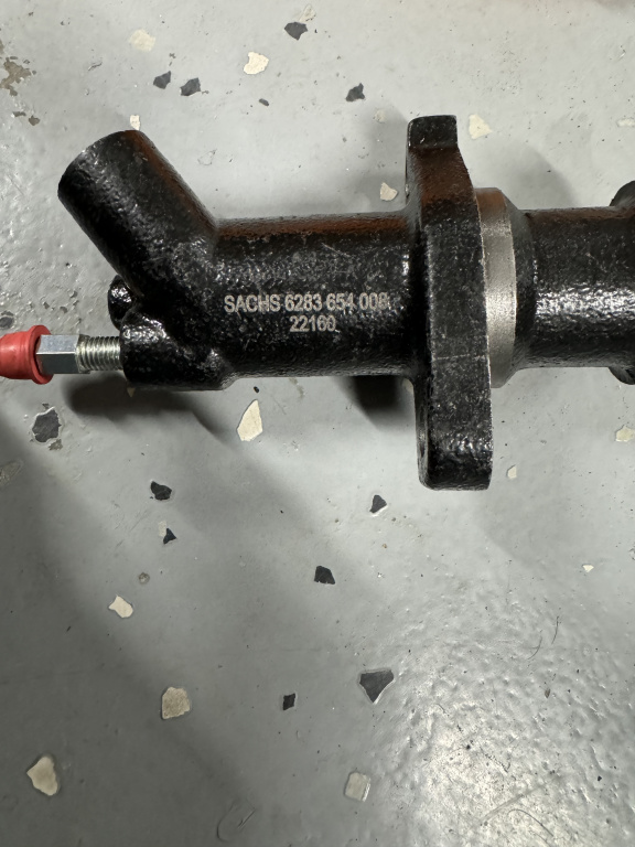

                    Found a clutch slave cylinder that I think will work and mates to the E30 clutch line.
                    Click image for larger version  Name:	IMG_0339.jpg Views:	529 Size:	154.0 KB ID:	10112608
                    Compared to the E90 one.
                    Click image for larger version  Name:	IMG_0338.jpg Views:	495 Size:	140.5 KB ID:	10112611

                    Unfortunately I won't know if it actually works for a while but I'll update this if I have any issues once I get it running. This slave cylinder does work!
