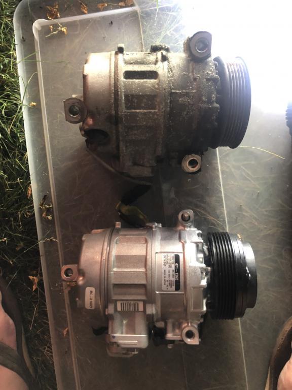

                    OK... I know I said no more AC updates, but this might be the AC solution... so I might get away with it. I haven't worked on the car for a week because of a trip and work, and now it's raining, but I did get out to pull the tarp off the engine two nights ago and I think this is worth sharing.
                    I'm and engineer, but not an electrical engineer. I DO have pretty consistent contact with two pretty savvy practical hardware design electrical engineers both with an interest in this project. We were ready to design a PWM controller for the n52 with off, low, medium, high output settings that pulled a "safe to operate" signal from the e30's AC controls (pressure switches, evaporator temperature, dash buttons, defrost lockout) and then sent a soft-start output signal to the compressor that picked an output from engine RPM (higher RPM requires less output). I have a few PWM controllers lined up on the bench, I pulled out my variable DC power supply... and then this arrived in the mail:
                    Click image for larger version  Name:	IMG_8742.jpg Views:	0 Size:	58.9 KB ID:	9943285
                    The top is the N52 compressor I pulled off (you can see my AC Comp label on the plug I snipped from the harness to start poking at it). The bottom is the compressor from a BMW M73. I didn't know that engine code off the top of my head, so don't be shy if you didn't. It's the V12 from the 7 and 8 series from 1994-2001. In other peoples underhood photos from those cars, it looked suspiciously similar, but as far as I can tell is a conventional clutch operated compressor (confirmed via the 8 series ETM, the fact that the wires go to the front instead of the back, and sheesh it's from 1993). I started this search by looking at serpentine belts. Most BMW compressors are driven off a secondary belt (which is why they're so easy to delete) which has a narrower width and fewer grooves on the pulley. For whatever reason the M73 is driven off the main belt like ours, and had the same number of grooves. They were both Denso OEM, and I figured if they looked this similar there was a decent chance that the bolt faces and pulley location were the same. All of the compressors from this era look like they use a bracket to adapt to the block:
                    Click image for larger version  Name:	Capture comp.JPG Views:	0 Size:	79.1 KB ID:	9943286

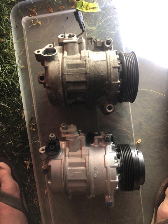

                    Which made me think they were using some Denso standard for the mounting. The N54 has aluminum inserts directly in the mag block that the compressor bolts to. I looked for junkyard compressors to check fit, but as soon as I realized that a new M73 compressor was half the price of a new N52 compressor OR an original e30 compressor, I just bought a new one (and figured if it didn't fit I'd just return it. Here's the back-side of the two compressors:
                    Click image for larger version  Name:	IMG_8743.jpg Views:	0 Size:	56.3 KB ID:	9943287

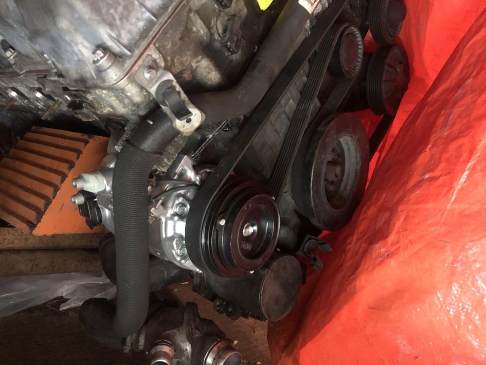

                    The housings are so similar that I find it hard to believe the internals are different... but... I'm not going to second guess that. I offered the compressor up to the block and it "fooped" right onto the aluminum bosses... exactly the same pattern and diameter. I was so surprised I didn't even measure the pulley diameters. The new one looks a little smaller and might be under-driven at idle, but this is probably helpful for a higher revving engine (ok ok ok... stop PMing me... smaller is overdriven. helpful for... not having to raise the idle when the AC comes on. how 'bout that). There's enough movement in the tensioner to make up the difference if there is one:
                    Click image for larger version  Name:	IMG_8744.jpg Views:	0 Size:	83.7 KB ID:	9943288
                    I better check if it clears my radiator...

                      That's awesome, and makes wiring so simple (just use E30 wiring!). I'll bet you can swap out that pulley too if it's interfering with the radiator.
                      I'm sure you already know this, but just make sure you use aluminum bolts instead of the steel ones that probably came with that compressor. Was it remanufactured? it looks brand new.

                        Maybe the fakes are getting this good, but this looks like a new production japanese made Denso. Their part number for it is 471-1262, and I expected it would pop up in a bunch of different applications based off that number... but it doesn't seem to. I'm sure this is some kind of internal code they use like a 471 pulley is a certain belt width, certain diameter, and the case is a 1262 which is a certain type of pump, certain pattern, and certain output, but I haven't been able to read those tea leaves.
                        It's such a low volume part I can't imagine there's fakes tooled up (on the other end of the scale, it's almost impossible to find a real Denso gear reduction starter for a Ford 7.3L diesel...) The packaging is also labelled "no core value" so these may not be rebuildable.
