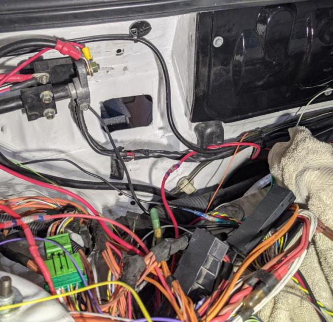

    I don't quite know where I'm going with this, except that I have a huge wiring mess living in my battery tray, and the original grommet and firewall pass-through are impossibly small. We're a long way removed from a motor with a distributor and only a handful of wires for the injectors and a few sensors. Yeah, I could disassemble each connector down individual plugs and maybe squeeze them through.
    I'm envisioning some kind of a flange with a lip that I can wrap a rubber seal around the wire bundle. The EKP will go in the right, rear side panel cavity.
    Also, the battery terminal is moved one hole to the left.
