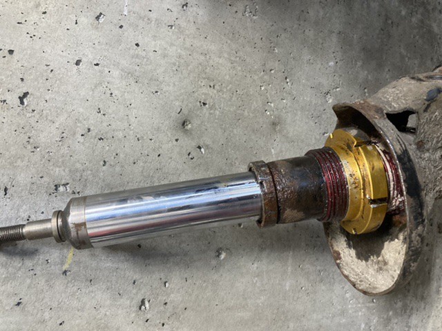

                Having a hell of a time with the front suspension. Every ball joint just spins when I try to separate them, even the friggin sway bar attachment at the strut! Took some creative wrenching to get the strut housing out!
                Anyway, I have the front strut housings out but can’t figure out how to get the actual strut out of the housing. Everything is corroded pretty solid so don’t want to start hammering on anything until I know what I’m doing. Soaked in PB plaster for now.
                Can anyone help?

                  Yours do not look to bad. Keep working the PB in for a long time. Do you have a big chunk of metal like an anvil? Below the gland nut, I use a small hammer and just tap away all around the circumference, backing the assembly up with the chunk of metal, to try to loosen up the rust. If they are super stubborn, I use a dull cold chisel and whack away around the circumference about 3/8" apart. The method works extremely well, but patience is your friend. I have waited a week hitting the part with PB a couple of times a day.The Billy gland nut is robust so not much worry of it breaking.
                  One must keep pressure on the joints below the balls while removing the securing nuts. I usually keep a second jack on hand for this purpose.

                    Thanks for the advice! Yes they are not too bad. Definitely keepers. Plan on wire wheeling them and painting.
                    So the gland nut unscrews (after beating on it awhile)? Weird that it is round so there is no way to get a wrench or channel locks on it. I guess just use a screw driver in the slots and bang on it with a hammer to unscrew it?

                      Bilstein makes a tool for it - I cannot remember the size. The smaller size is harder to find. I tap below the gland nut on the housing itself, but not on the gland nut - just enough to break the rust bond.

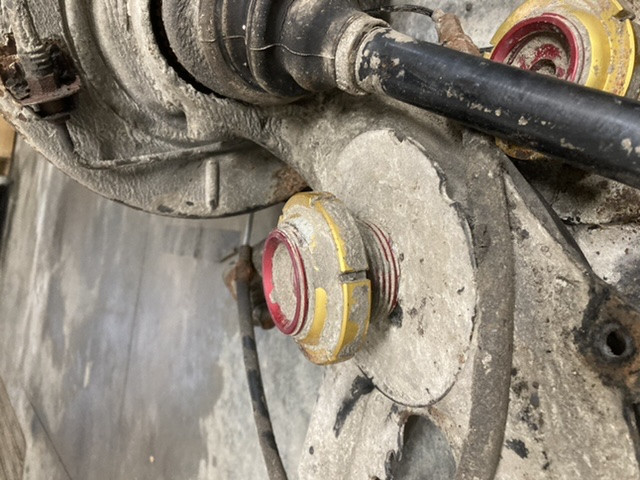

                        Got the rear subframe out and took off the rear trailing arms. I’m wondering if anyone has experience with the GC rear adjustable springs on my car? I want to remove the rear adjustable spring perch but don’t want to destroy it in the process. Seems pretty well attached and not sure what to do to remove it. Any suggestions? Pic rotated when a I attached it as it always seems to do, sorry! I live on a dirt road that’s why its caked in dirt…
                        Thanks!

                          I have *never* in all of my years gotten GC rear adjusters off without destroying them. I have tried every method under the sun. The only time I actually got one removed, it was destroyed in the process, and that was with a pipe wrench.
                          GC used to be cool and would sell you just the threaded piece on the cheap so it was no big deal, but they no longer support their customers who need individual parts for setups we've already purchased, and they just expect you to buy a complete new kit/parts every time you need something.

                            Haha I was waiting for you to respond!! I know you have experience with GC.
                            I kinda figured after monkeying around with it for an hour or so that it wasnt coming off. Did you try heat? Thats the only thing I havent tried.
                            Any thoughts on the fronts coming off??

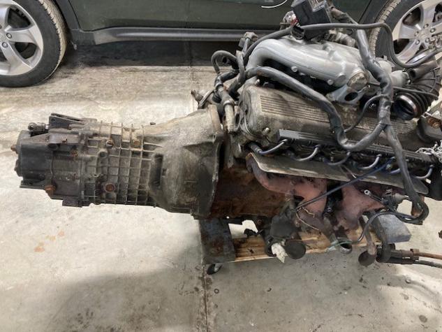

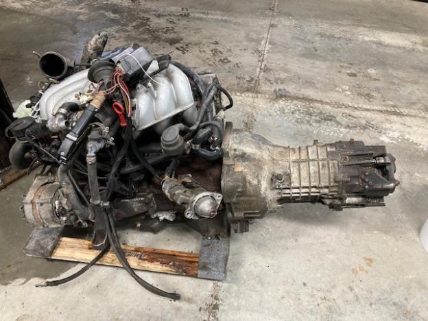

                              Hey Guys!
                              I got the engine/transmission out (the bottom) this morning.
                              I am having trouble separating the motor from the manual tranny though. All the bolts are out and it slides back an inch or so and will rotate but is getting hung up and wont come off.
                              Any suggestions?
                              Thanks!

                              • E30andy
                                • Aug 2016
                                • 504
                                I figured it out! Just had to take some weight off the tail end of the tranny and it slid right off.
