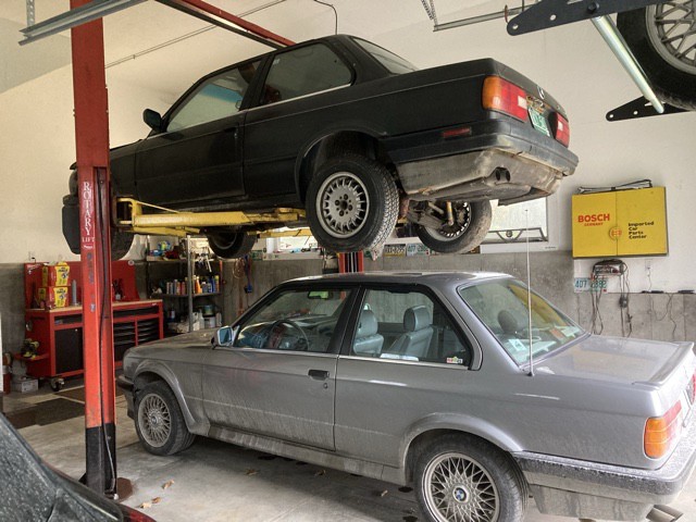

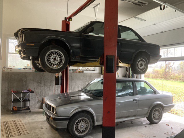

    Couple of pics….

                        Started doing some dismantling today. Figured I would start with the transfer case but need some advice.
                        Looks like I will need a transmission jack to support the tranny while removing the transfer case. My issue is I park my other ix under the one I’m parting out. So after the transfer case is out can I remove the transmission jack from under the tranny and just let it hang? I obviously can’t park under the parts car if the transmission jack is still there supporting the tranny but don’t want to just let the tranny hang if it’s not safe.
                        I wasn’t planning on removing the tranny yet but if I have to I will.
