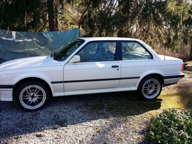

      • Nisse Järnet
        • Aug 2013
        • 1221
        #168
        17x7.5 ET38
        E30 325ix M50 turbo 7 spd DCT 4wd 840awhp @ 31 psi.
        E30 M50 6 spd 764whp @ 24psi.
        E30 M20 6 spd 675whp.

          What size tires do you run? Any issues with rubbing?

              • Nisse Järnet
                • Aug 2013
                • 1221
                #172
                Me? The car is still on stands haha so i dont know but it looks ok :)
