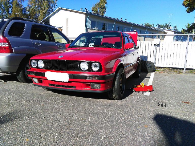

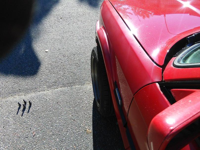

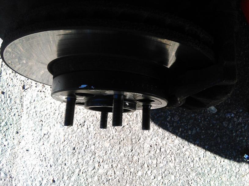

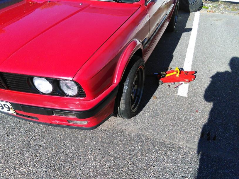

    And here is some pics, i ad in front that 20mm adapter and back is still whitout that.

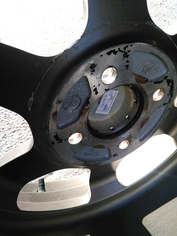

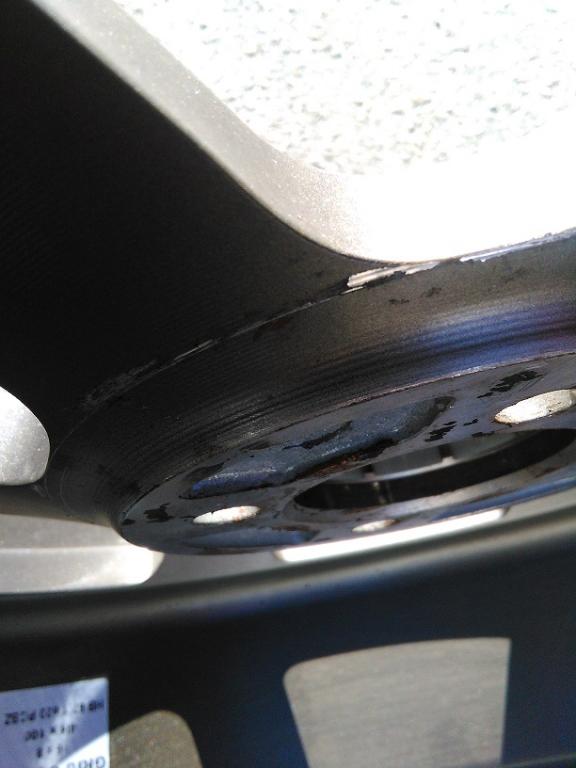

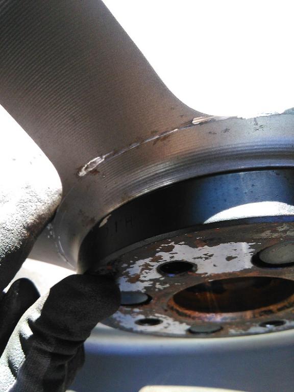

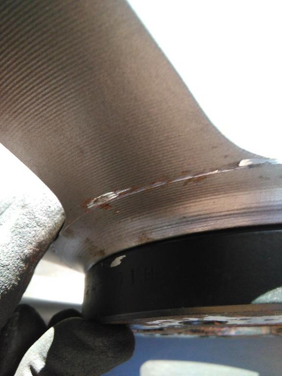

      And here is few pics ix rims "problem"
      So my rims was meant to like fwd car, like Honda, so thats why the rims looks like this inside.
      As you see that surface in that position/are, where that rim will attach is flat.
      Those last two pics are
      And here is few pics, how that rim should look, when they are meant to ix, not sure are that same in rwd e30. At back there is bit problems.
      I was add that 20mm adapter in that rim, so you can see that edge what i mean.(that is that black part)

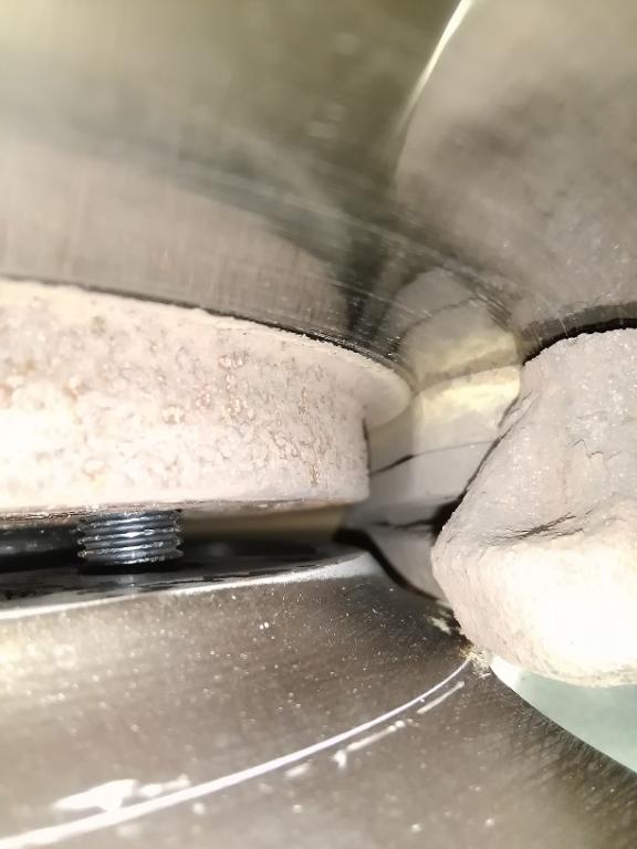

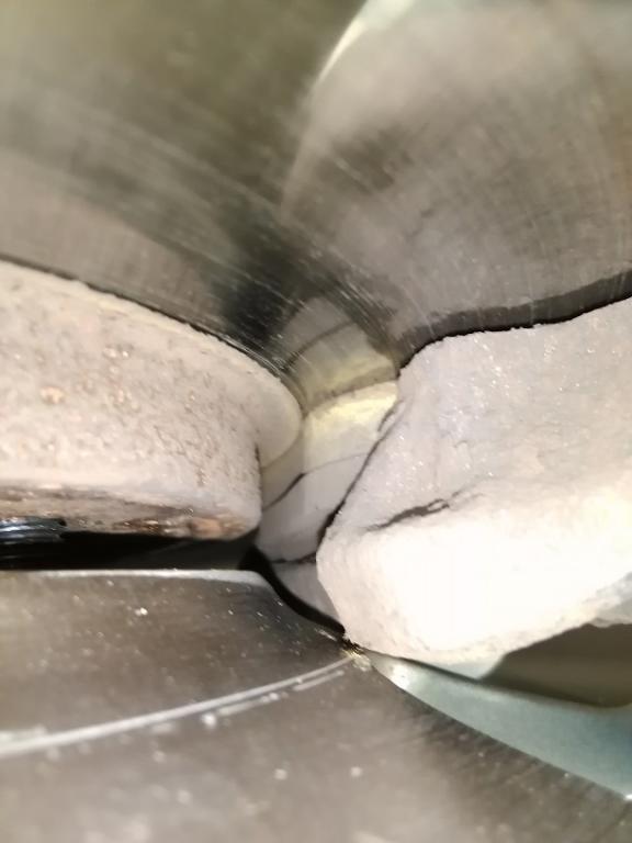

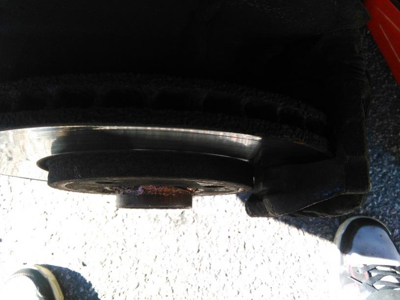

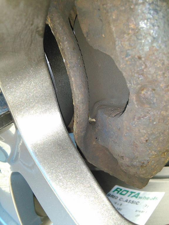

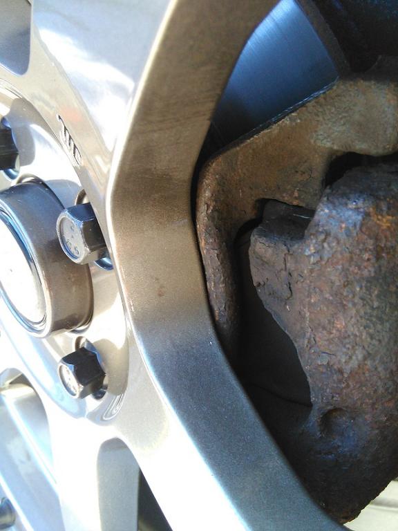

        And here is those same issue at hub+you can see that front brake caliber rack.
        That first pic is whit that 20mm adapter, you can see what i mean, now..
        No that rims fit roll.
        Those 2 other pics are for show, how much that front brakecaliber is comming out.
        Also there is little different in ATE and girling brakes

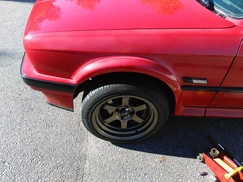

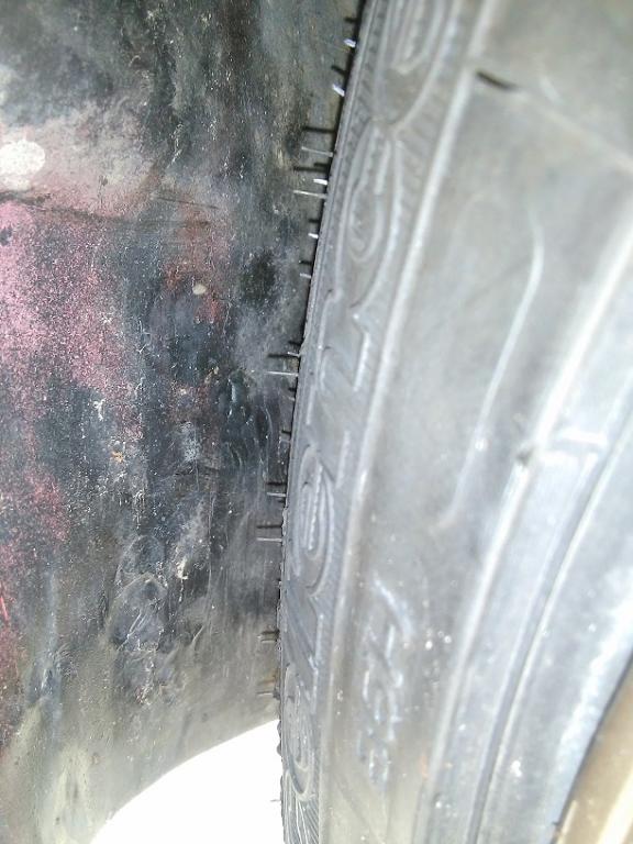

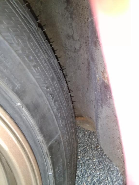

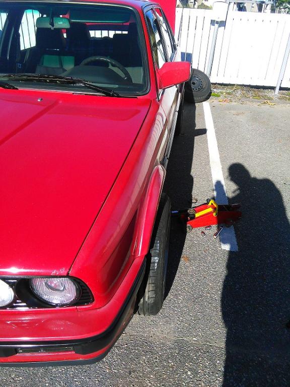

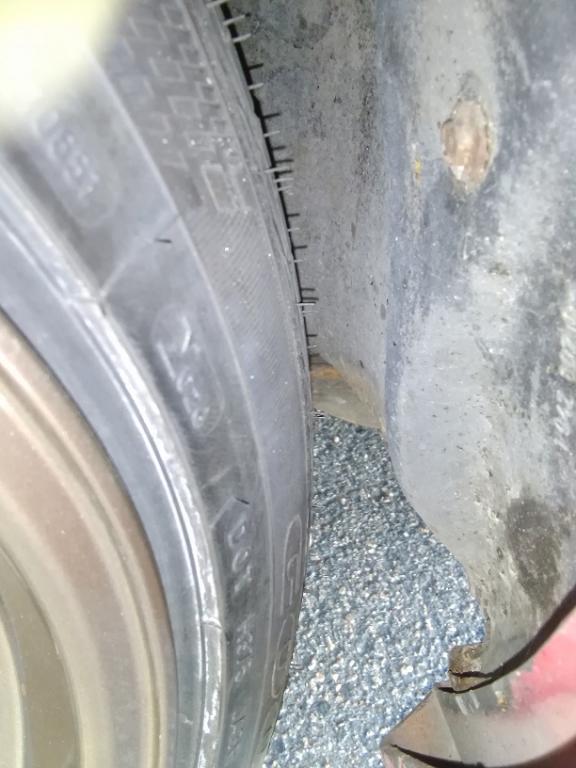

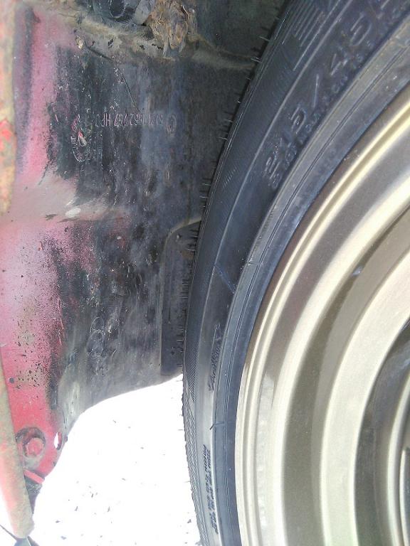

          Also here is some last pics, it will rub those same spots, at back...
          And front there is those spots, at front side at that tyre, when you turn those wheel max, when that tyre will go very close at front side wheel, like here.
          Here is few pics first whitout that 20mm adapter and few pics whit 20mm adapter. Also some pics when you turn wheel max, you see that space and back side tyre, that spot.
          I was need to heat that front inner plastic fender, to clear it

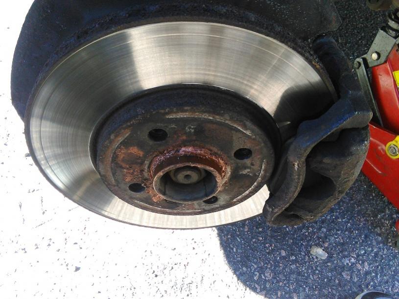

            And here is few pics, to show that front caliber rack issue. First pics are whit out adapter
            At back i would want like 9" wide, and ET should be more that way, so those back rims have more lip, maybe ET 0
            At front if can turn, also 9" wide ET shoul be like 20, whit out that 20mm adapter, so that rims should mean Bmw ix to clear that brake rack issue....
            I hope in future i would get those 3pcs rims, what is made for Bmw, then all size would be easy, just but that part mid(where is those spokes) part to hub and measure those space inside that mid part how much there is space to that suspension part and then measure how much big lip you make fit in there
