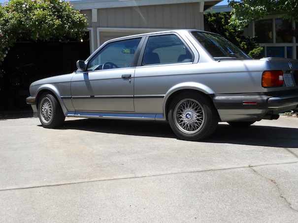

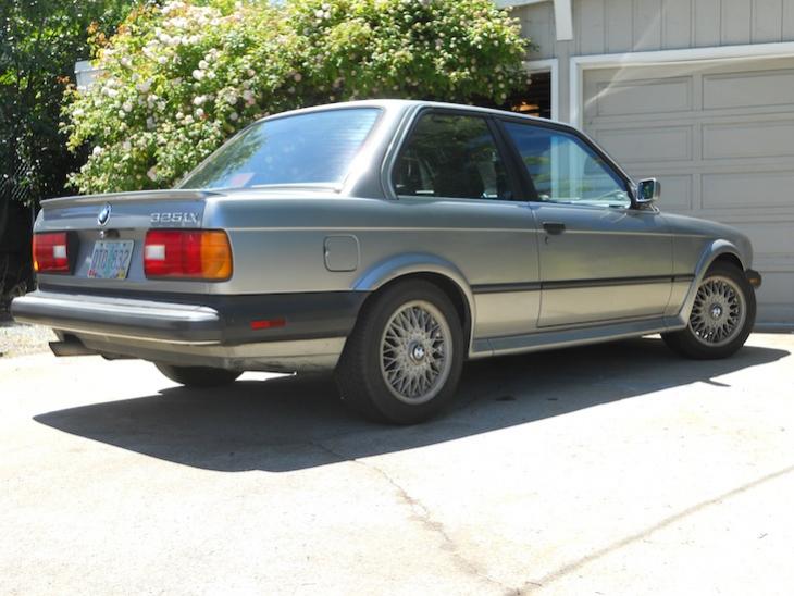

                          Bilstien / HR set up
Name:	88 IX E30 Voldemort-r3v format.jpg
Name:	88 IX E30 rear quarter-r3v format.jpg
ID:	7139551I believe that's what I've got on mine.
                          I love it! Probably drops the body 1.25 to 1.5 inches, just a guess.
                          No prob with rubbing stock weaves, skinny tires for some reason ( 195-60-15) what the PO had on it.
