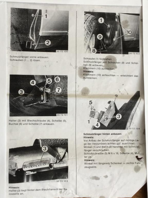

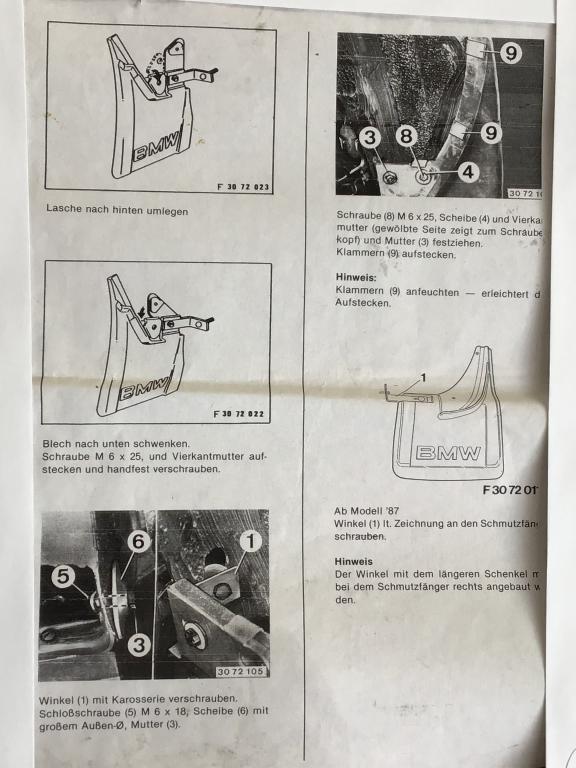

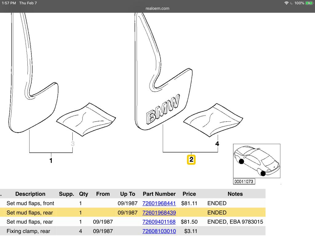

                  Moving this over from parts section. Thought it might come in handy for the metal fab and small parts list...
                  I concur, The E30 rear mudflaps are all the the same. Just for quick reference I will post realoem iX mud flap page and the 3 pages of instruction that comes with the part from OG
                  The mud flaps are one thing but the mounting hardware is another, so fabrication is going to require metal work as well. I can’t remember....Maybe the metal brackets for the front are the same as the rwd e30.?
                  I tried some on my ix years ago, and IMHO, the mud flaps are just another spot to collect dirt, sand, and salt.

                    Did they make late model flaps for the iX? If so, anyone have a part number?
                    My 325iX DIY Threads:
                    Front Wheel Bearing Replacement
                    325iX Rear Subframe Bushings and MUCH more w/pics!
                    325iX Steering Rack Replacement, Suspension, & Oil Pan job w/pics!
                    • nando
                      • 34844
                      #325
                      yes, that's what this whole thread is about. ;)
                      we never had the early ix over here, but I'll bet theirs are NLA as well (the fronts).
                      The rears are the same as any late-E30.
                      Build thread
                      Bimmerlabs
                      • EyExR
                        • Jan 2011
                        • 959
                        #326
                        The part number is listed as “up to 09/1987”. Doesn’t that mean they wouldn’t fit on a later year?
