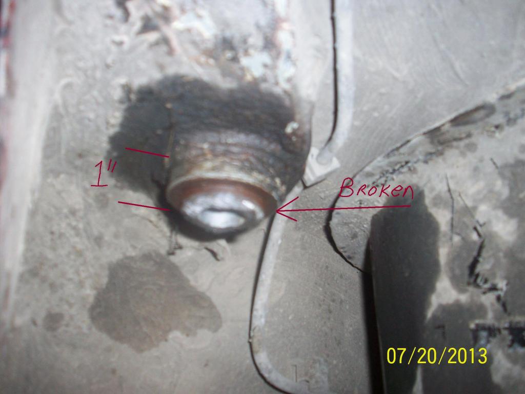

    Changing the rotten rear subframe bushings and while lowering the subframe - I broke both bushings right below the big top washer.
  • 95BMWIC
    • Apr 2012
    • 353

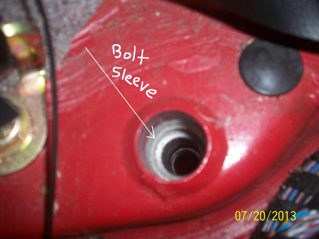

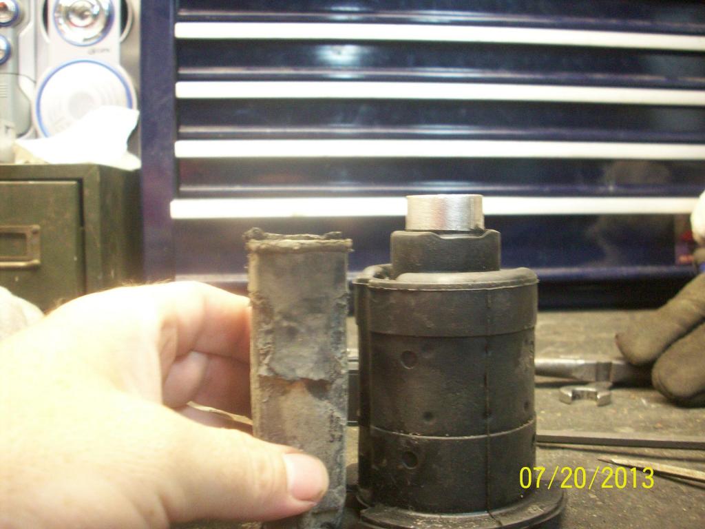

    The bushing sleeve is made of pot metal - it is rusted / seized onto the frame - it broke about an inch down - 1/2inch still inside the tube that runs into the body under the bench seat.
    • 95BMWIC
      • Apr 2012
      • 353
      Any thoughts on how I can remove the remaining sleeve?
      Can I push it out from the top using a thin socket - tapping the top of the bolt splined sleeve?
      Or is it better to drill it out - or chisel it out from the bottom?

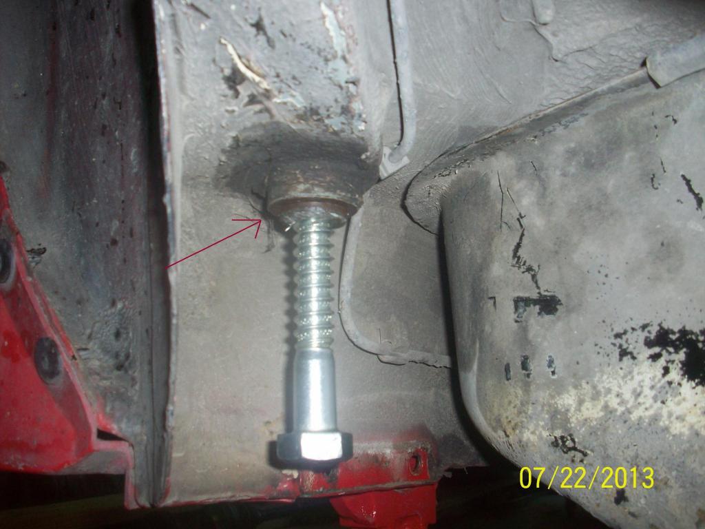

                Followed instructions:
                5/8 Lag Bolt Inserted

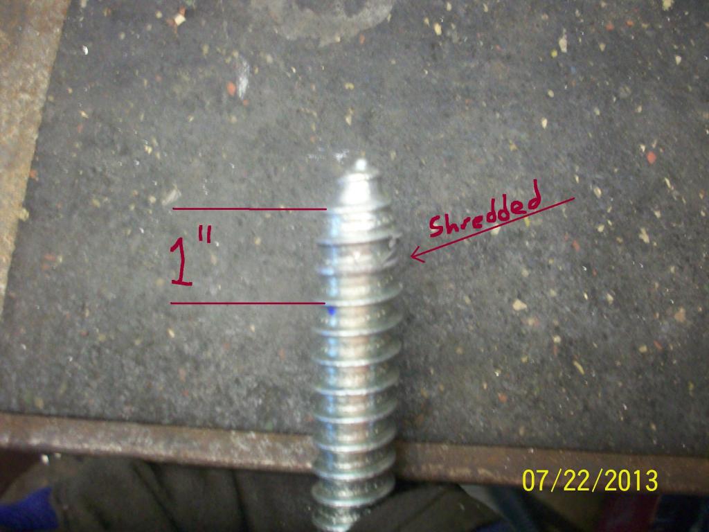

                    Beat On Bolt.. Only to have Bolt Fall out after 10 -12 Hard Blows.. (Did this twice - with another new lag bolt - not even a budge..
                    Now What? Punt?

                        That's why I used a 5/8 tap on mine and then inserted a 5/8 bolt. Much more thread engagement that way.

                              insert the lag bolt further. keep at it until the thing pounds out.
