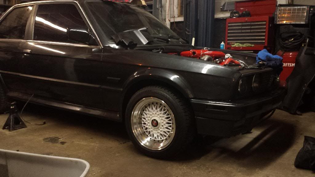

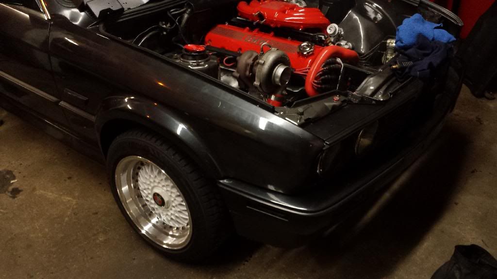

                              These are just temporary wheels until the o.z. fitipaldi fitistars get filled and redrilled. But I found the exact look I wanted the car to look like in the meantime. Maybe just a half inch lower would be better.. but im hoping as I drive the new springs will settle down a bit. Is this just a myth? (H+r sports). Coils could not come any sooner!!
                              I also started putting together my project list for lelas sister "mila"
                              Here she was last season before I removed the head. A couple pics of her good angles.. lol
