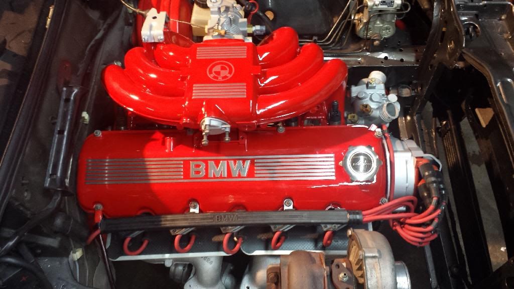

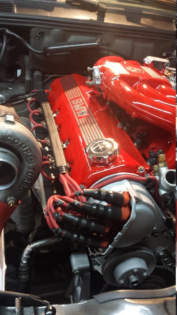

              I love that IAT setup. When/if I ever revisit my charge piping setup, I may steal that idea.

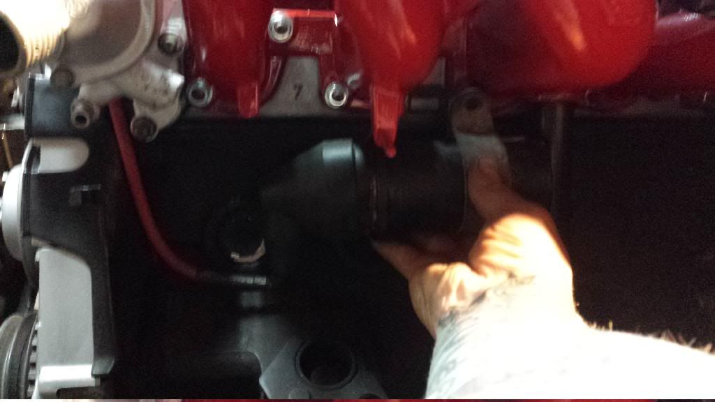

                My mistake on calling it a valve. I'm doing the work from my phone, typing is difficult.what I meant to Say removing the valve, and tapping in the iat, sensor. Horns were installed to make sure people know when I've arrived to pick them up. (Mainly my girlfriend from work) and to make sure idiots driving in the city K ow.to stay in there lane. A lot of dumb drivers in my area. Gotta keep the warnings loud as possible!

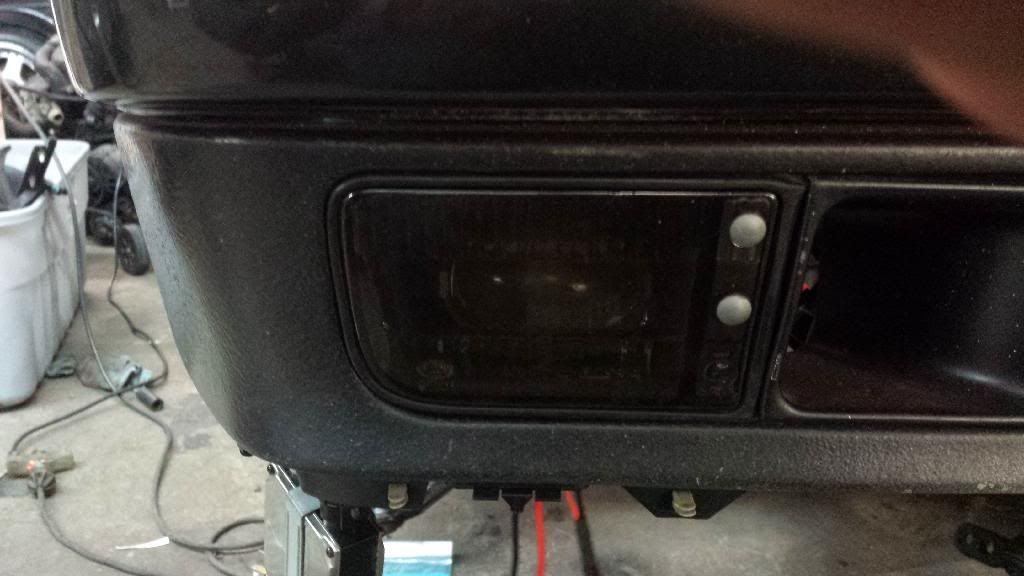

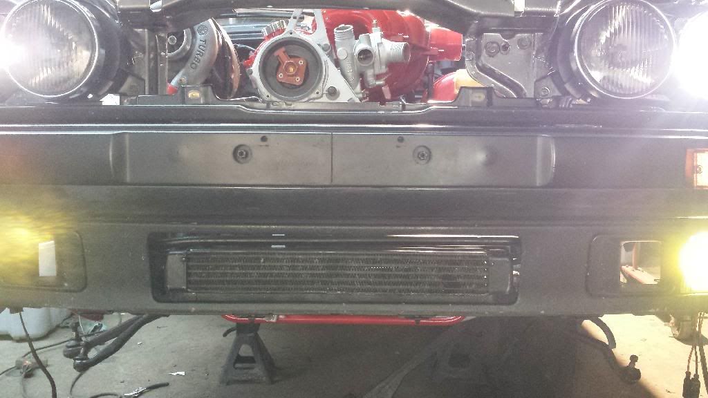

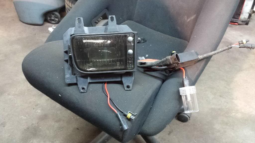

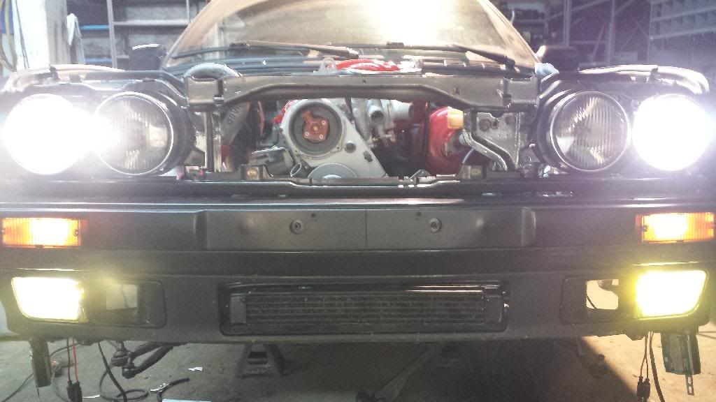

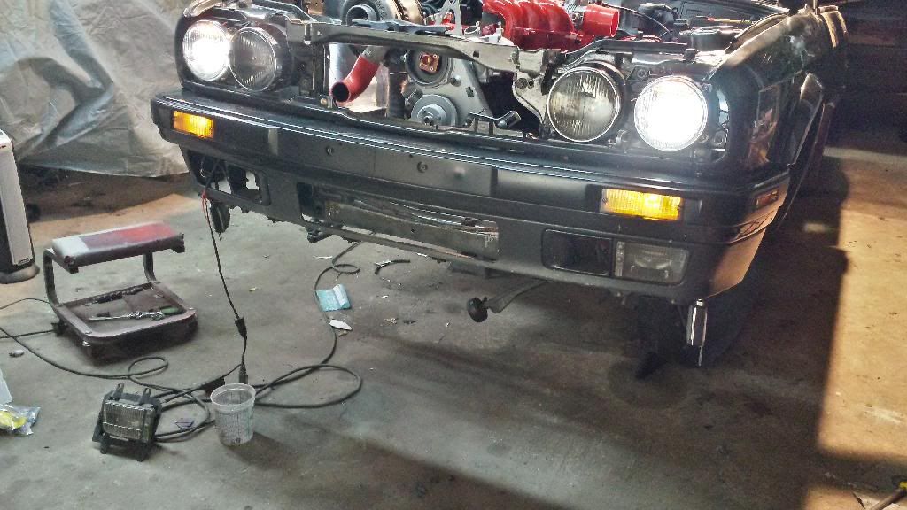

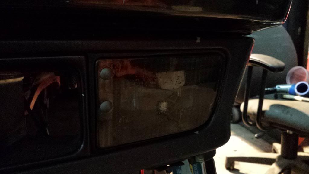

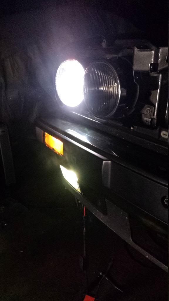

                  Today I got quite a bit completed. I installed my hids, hard wired and installed a relat/fuse kit. Low beams and fog lights are done. Debating what to do with the high beams... Also tinted the fog lenses as well. 300 install to stay yellow without doing the typical yellow film.
                  Let there be light! (Notice there isn't any tint of blue! ;))
                  Odd color from camera. . It's a super white, purlle. More white.
                  All together:

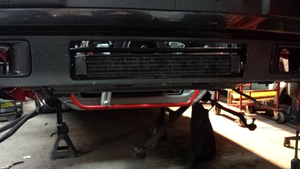

                  Another large taste of the day was relocating the factory oil cooler to the front lower opening of my valence. I think this location makes things much more efficient and Fills the void nicely. Bending the lines was difficult, especially pulling them away from the turbo manifold, I may put a little heat reflector onto them to isolate temps even more. Thoughts?
                  It could be cleaner, but I feel it got it as even and level as possible. It's far away from the bottom of the valance too so chances of damage are very minimal now.

                    Nice, are those 4300k?

                      #100
                      Yes. 5000k is too blue and actually has less lumens. Even though many people would argue this. They are oem osram xenarc d2s 4300k bulbs, philips ballasts, with acura tsx xenon projectors. The lenses were modified to make a crisper cutoff line at 25 - 30ft. All oem level adjustments still can be utilized. It's a very confident and lasting setup. I did want to post pictures of my install, but I provide retrofitting services to people at a price and cannot reveal this as I have with many other things I've shown.

                        Nice. I don't really think there's too much difference between 4300k and 5000k, what really stinks are 6000k or those retarded 12000k lights. ugh.

                        • imwhyteyo
                          • 1165
                          #102
                          [QUOTE,=nando;4031446]Nice. I don't really think there's too much difference between 4300k and 5000k, what really stinks are 6000k or those retarded 12000k lights. ugh.[/QUOTE]
                          It takes a very particular eye to notice... but a good way to tell the difference is through a projector. That helps deflect the light as if thru a prism.. now say the cars traveling a quarter mile down the road.. you see the car hit a bump and the angle changes revealing an off tone of color opposed to the white color itself. 5000k you'll see that blue flicker. 4300k you'll see a yellow/purple flicker. The difference surely is minor. But I'm picky.. I have been doing HID retrofit systems and hobbying the tech for almost 10 years so it's easy for me to spot. You'll notice most Bosch projectors (audi / VW / porsche) have that slight blue hue to them.. where Stanley projectors (acura, lexus, etc.) Give that "brown" light I call it.. (yellow/purple) this is from the quality of glass being used. Most universal HID based projectors are Borofloat for the thermal properties.. but the nice quality projectors, Fused silica glass types heck ever swarvosky crystals are even being used in some Mercedes Benz lenses now. Now when these guys put hid light systems into halogen based projectos, that we find in ALL of our e30 ellipsoid, euro, Or usa the light dispersion is scattered alot more.. generally those lenses are acrylic ... or lead based glass. This is where we see stronger color deflection and loss of direction in lumen. Most people fail to realize this and stuff these type of projectors into ellipsoid and think because there's a cutoff that it isn't blinding the oncoming traffic. Of course it isn't as bad as a reflector based housing.. but it's not a 100% direct path. The cutoff shield quality and design of reflective material in the e30 projector bowl was only engineered to handle the small wattage and minor lumen production of a halogen bulb, maximizing it's output and efficiency.. overpowering it with an hid bulb creates an overflow of light so to speak, as well the heat changes the property in the acrylic and makes odd deflection . All qualities of material failure, danger of fire from melting units or from failed circuits, as most people don't even run relay harnesses.. also, danger to blinding other drivers as well, this is why I always recommend a professional install of a relay harness at the least, but an hid based projector housing retrofit is always the better way.

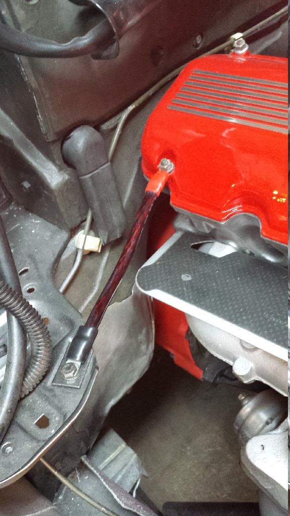

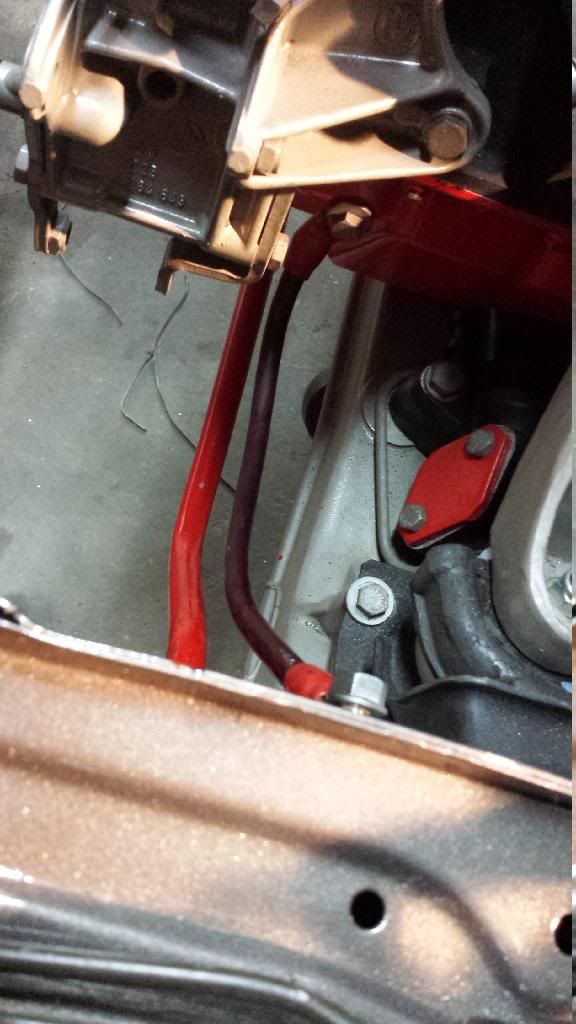

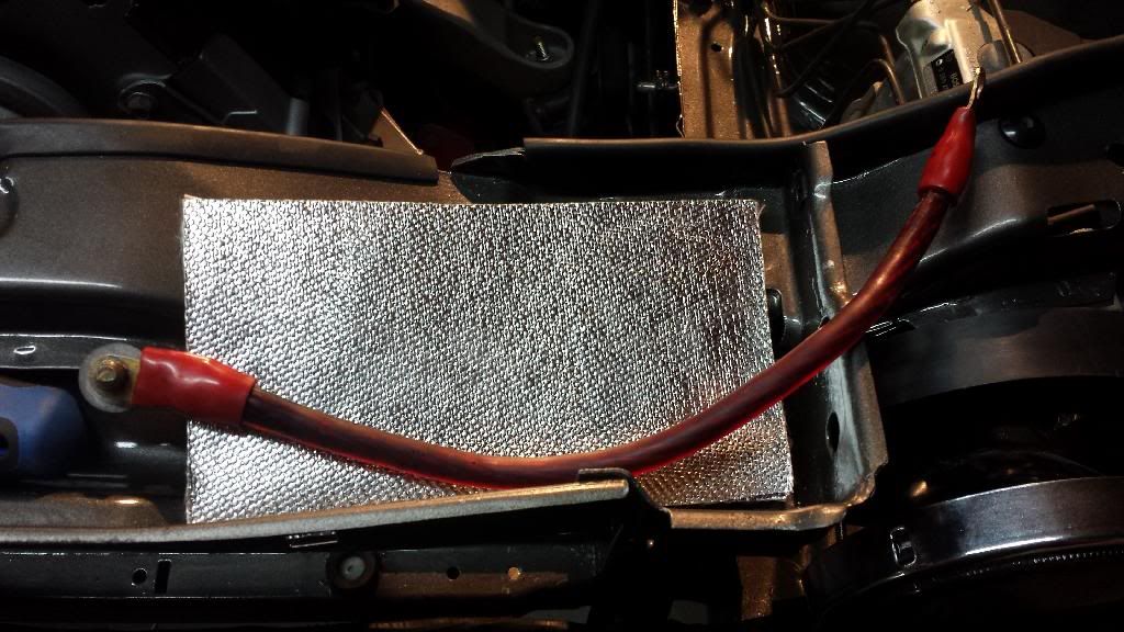

                            Did alittle wire action..! New upgraded grounding straps for the engine. I will be creating a new starter/alternator power wire out of 0awg. In red (for the theme)
                            After the alternator gets a internals rebuild and a sandblast if the outer case, this will allow me the chance to start considering wiring of amplifiers for the extreme stereo I'll be installing.
                            Also tinkered with the spark plug wires.. hard to make these look any cleaner.. I'll be relocating the ignition coil far away from the potential of heat from the turbo. Under the intake mani it goes!
                            Someday I wish to mimic nando with his wasted spark design. Wanna fab up some stuff for me buddy ? ;)

                              hella projectors are 100% glass, not acrylic, though I don't know the specific type of glass. I doubt if they're leaded glass, the ones I have were produced within the last 10 years, and lead is banned in most manufacturing these days. I disagree that a relay kit is necessary at all, the worst thing you could do is blow a fuse (which I've never had happen once), although this may depend on the quality of the ballasts. I do agree that an E30 projector isn't 100% perfect but it does work pretty dang well for being so old! certainly better than the #$^%# lifted 4x4 trucks with 8000k HIDs in reflector housings that are EVERYWHERE here. god damn those things piss me off!
                              I'll be switching to a projector retrofit kit pretty soon anyway so we'll see how much better it is. :)

                                #105
                                Originally posted by imwhyteyo
                                Personally, I'd want more slack in a ground strap than that.
