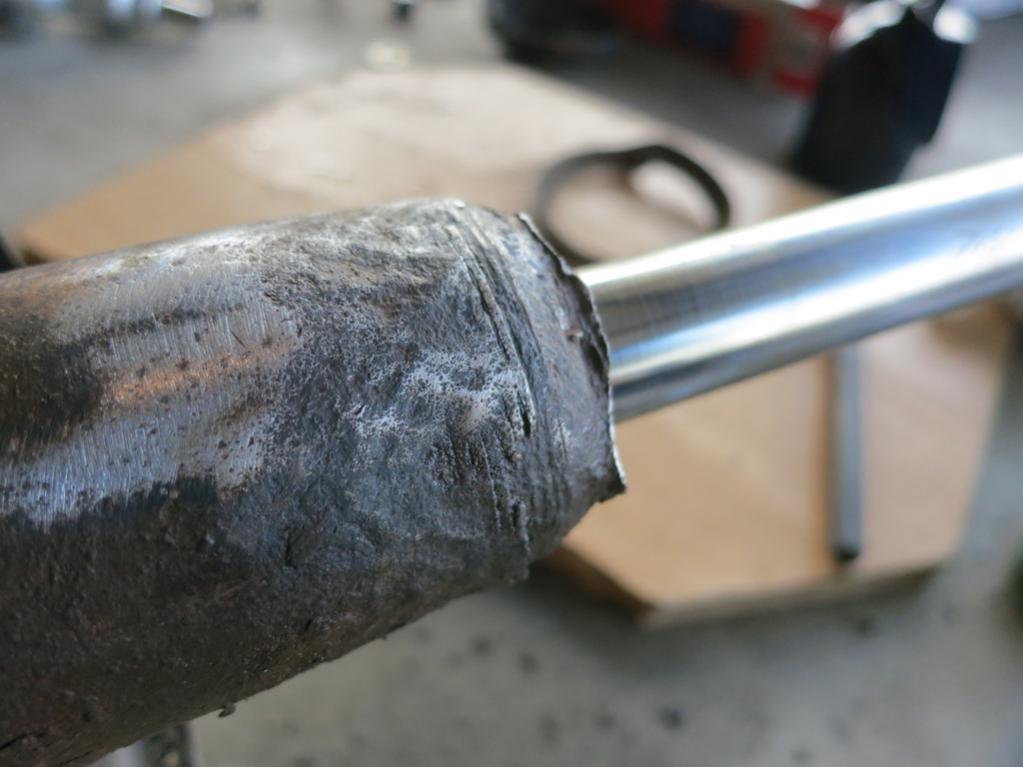

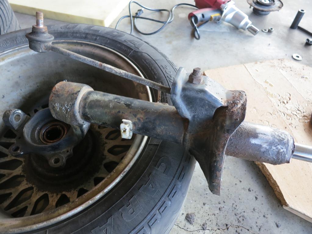

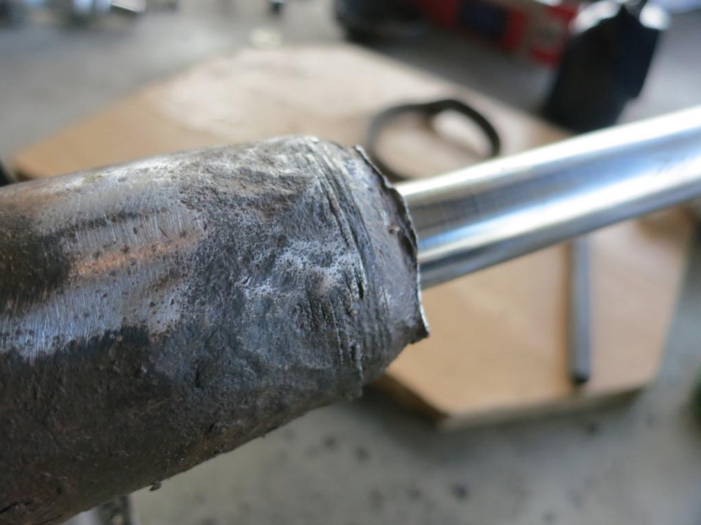

        Got the Bilstein's all done, but my glad nuts are BAAADDD.
        Any suggestions here? Just torch, PB Blaster and lots of effort???
        The one I have pictured is the worst one - you can actually see the threads! This is after hitting it with a wire brush... Suggestions or will this whole housing need replacing? I had considered having something machined and welded in though...
        My other strut looks a lot like TD's left glad nut - but it's pretty bad too. I haven't gotten either to budge...
        Man... my e32 and e30 were easy to do this on!

          #49
          Id look for a used strut. :(
          You could have a new threaded section welded in. Ix tubes are thicker, i think similar to the E36.
          My spare housings were just like that. I could NOT get the nuts off - I was doing coilovers anyway, so i just cut them off.

              #51
              Wow, those are bad.

                #52
                check ebay - I've seen them go for $150 or so.
                keep the old ones in case you want to do coilovers some day far out in the future. :p

                  #53
                  I would definitely get used strut housings. I believe there are a few members selling some or you can post that your looking for used strut housings and I'm sure someone will pm you:D

                        Torch vise pipe wrench hammer. Repeat 3x in my case. They did come out but it took a lot of effort to break them loose. Heat is critical.
                        $500 for a pair of used housings is a total ripoff

                        • nando
                          • 34844
                          #57
                          The problem is his are so bad there is nothing to thread new gland nuts into.

                            #58
                            oh wow.. my bad for not looking at the pic attachments.

                            • Sean
                              • 5793
                              #59
                              Yea, thats just the passenger side though. I think the driver's side might have some material left there, but won't be able to check until Tuesday night.
