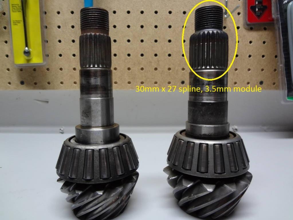

                  #338
                  E34 on left, E46 on right:
                  it's hard to tell in the pic but the ring gear is definitely too thick for it to mesh up. you'd have to cut down the backside of it. the bolt pattern is standard BMW 168mm.
                  looking at it again the bearing on the pinion is the same but the output shaft is bigger. maybe there's enough room to machine the case to fit the E46 pinion and flange, dunno.

                      Have calipers handy? What's the diameter and spline count of the splines on the E46 pinion?
                      • nando
                        • 34847
                        #341
                        30mm OD, 27 teeth.

                          #342
                          Thanks!
                          30mm x 27 spline on a 3.5mm module. The largest module with a 90 degree face angle is 2.5, so those have a smaller face angle, which it looks like on the photos.
                          The driveshaft spline in the T-case is 35mm x 43 spline on a 2.5mm module, with a 90 degree face angle.
                          So one of the extended spline fittings could be made that had the front diff pinion splines and threaded shank on the end that normally gets welded into the driveshaft. This would allow the use of the E46 input flange at the T-case front output, which makes it easier to run a fixed yoke with u-jointed driveshaft.
