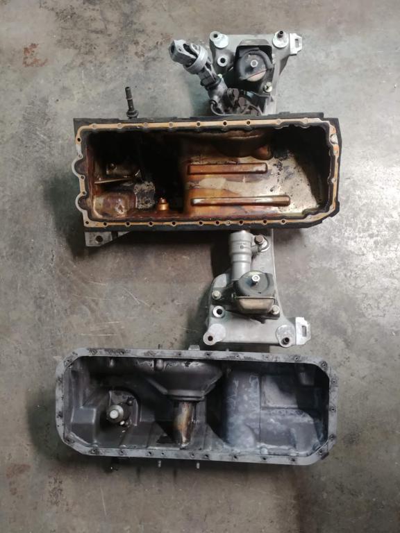

                Lately, I've been staring at the engine that's been in my garage for the last 4 years, and really considering doing the initial swap without AWD. The RWD 24v pans clear the ix subframe easily without any modification required - and I could have this swap complete with only having to finish the engine, and not a rebuild of the whole AWD system.
                I'm curious how it actually drives without the front wheels being powered. I've heard both good and bad but it's not done often. Also I would only do it until such time that I can finally get a AWD pan fabricated and rebuild my front CV shafts (which are in sad, sad shape).

                          • Jun 2010
                          • 2796
                          #1092
                          I found an eBay seller with both sides of both RWD and AWD mount arms for sale, so I grabbed all four.
                          Because of the right angle characteristic I noted above, it'll be SUPER easy to get the lateral and vertical relationship between the RWD and AWD mount locations from that one arm. It'll take a smidge more thought to get the longitudinal relationship, but I think that's readily doable as well.
                          Also, does anyone know how much the M20 powertrain is tilted front to back?
