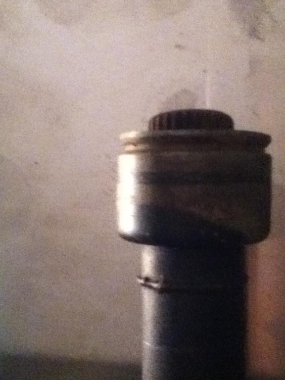

                          I don't think spline wear had manifested itself back then. you didn't really start hearing about stripped splines until near the end of the decade - and I still believe that to be a lubrication/maintenance issue, not a structural or mechanical issue. if they rust they don't stand a chance..
                          I think the E53 splines are similar to the ix.

                              525ix picture for reference. Notice the diameter and tube base compared to the 3series. I think Nando is correct, it would be a maintenance issue as it seems to rust quite easily.
